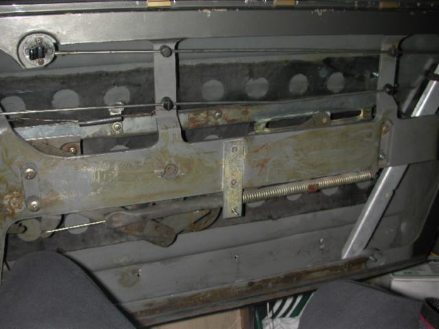

Here's a pic of the plate.
Note the li'lle screw in the bottom hole. I used that to mark the card on the 280 which didn't have the hole drilled in it.

By the way, does anyone know if those small rubber thingys that help hold the lock rod mechanism are available? You can see them in Naj's photo.

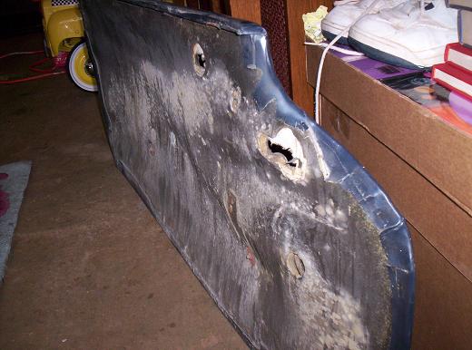

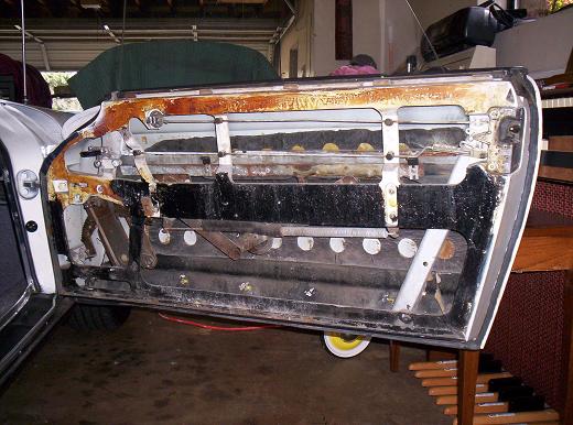

Well, I did some exploring. My door seems a little different inside than Naj's. No bracket and a lot more grunge....
If you look closely, there is a small screw hole that might possibly be where original card screwed in. Also you can see how warped the card is on shot #2. Are they supposed to be completely flat or are there some undulations?

Re: Unwarping Door Panels

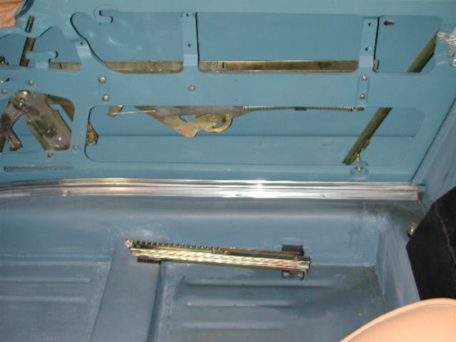

James,
There may be 2 holes hiding behind the black stuff.
The screw under the arm pad would actually land in the air space below the center member.
Hope you'll be able to see the holes in this pic. Also on a 230SL.

I think moisture has taken a toll on your card.
