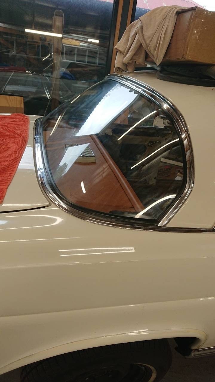

Front windscreen is going in on Friday... Here's the back all done.

Nice job. I have never looked at the rear glass and nice to see what it looks like before diving in. Looks like the rubber and glass went in first and was seated and then you install the chrome trim on that.
Looking forward to the front glass install. Things worked out for me except for the upper trim piece. Once seated, the rubber was a bit too low on the roof line in the center. I am mostly interested in which way the pull cord is oriented. Do you start pulling the cord out on top or at the bottom? Next time I do this, I will make sure the match the upper trim to the roof line. I think was slightly bent downward at the top and what caused the rubber to be too low.
