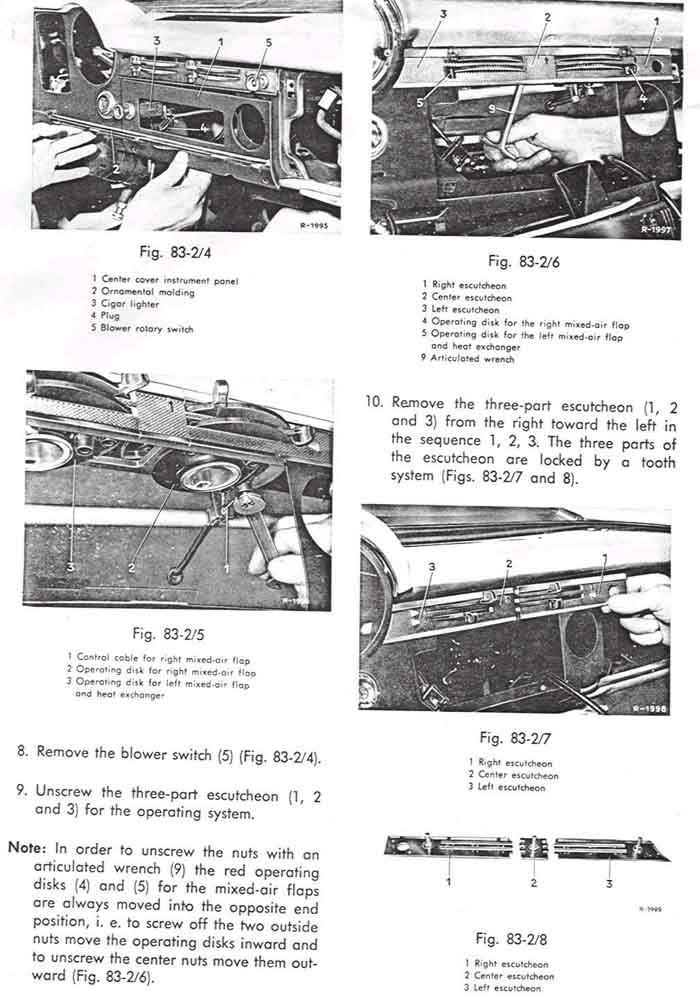

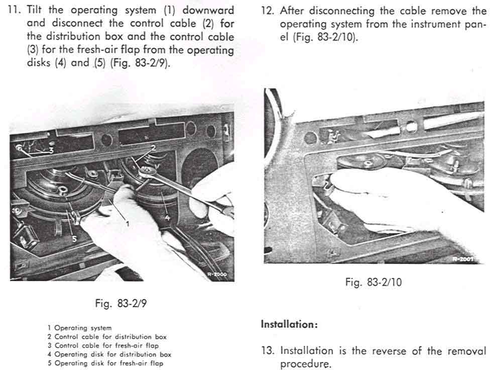

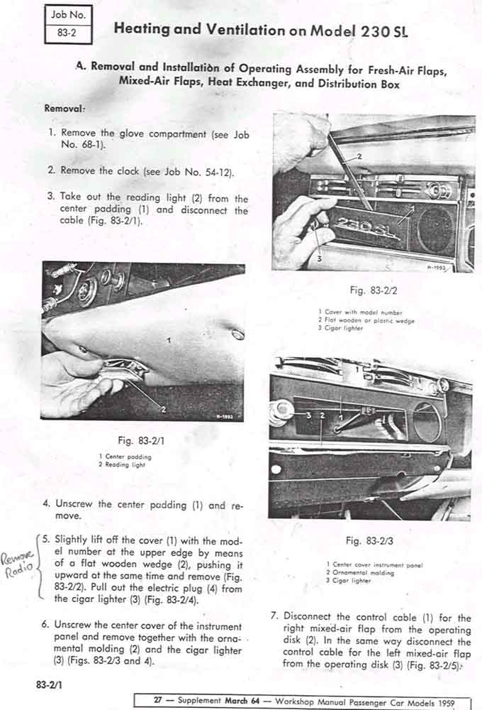

Service Bulletin for replacing the heater levers...also check the operation of each cable, lube where needed...might want to change the bulbs at the same time...part of one cable can be accessed and lubed from the round black rubber cover on top of the driver's side of the engine firewall.

Where do you find these diagrams/pictures?  Is this from the BBB book, which I have never seen?

Yes, Chad,
It's from the Big Blue Book, the "Werkstatthandbuch PKW-Typen ab August 1959".
It's still available (as a reprint) from DaimlerChrysler, either as a CD or paperback. It's also often offered on ebay.

I am following the BBB instructions as shown in the 3 pictures and have completed removal of the 3-part escutcheon (step 10). But now I am stuck in step 11 (picture #3).
In order to "tilt the operating system (1) downward" the levers need to be pushed in and through the narrow slits that were covered by the escutcheon. I can push the right side in somewhat because that control cable (2) is longer and will bend, but the left control cable (3) to the fresh-air flap is short and stiff and cannot be compressed. Who can help? What am I missing here or doing wrong?

Re: Heater Levers
« Reply #8 on: May 01, 2006, 23:15:52 »
I seem to remember detaching the cables first reaching through the speaker opening, glove box, and radio opening so I could turn the levers easier.  (Pre-tape your wrists and knuckles for the inevitable cuts)

  • Posts: 1179
Re: Heater Levers
« Reply #9 on: May 02, 2006, 15:10:11 »
Note: This service bulletin is for the 230SL's and the early 250SL's as the dash has a large metal piece that surrounds the radio and clock, that is removable.  The later 250SL's and 280SL's don't have this convenience.  Things are a bit tighter with those with sticking your hands through the radio opening.

  • Posts: 4774
Re: Heater Levers
« Reply #10 on: May 03, 2006, 21:48:22 »
Pete and Walter,
thanks for your comments. Detaching the 4 cables was the only way I could get it out - fortunately, no cuts, and all fingers are still intact  :) .
