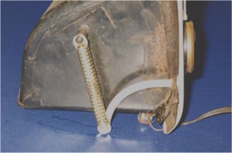

I think I sprung my spring.. My glove box has always closed with "authority" (slam).  I had it out to adjust clock speed.  I accidentally knocked off spring when I was reinstalling the box..I put spring on backwards.. played with it.. off.on..off..on.  Finally got it right and now it is barely holds the door shut.  What experience have others had with the spring?
Anyone have a picture of it properly installed on the box?

The spring should be straight and compressed between the two open mouthed 'spanners'.
Sorry, no picture.

Installed spring picture for you
Download Attachment: GloveboxSpringInstalled.jpg

Thank you one and all.. What great group this is.. :)
I won't describe how I had mistakenly assembled the spring (too embarrassed.)
It now works perfectly.' :D '
