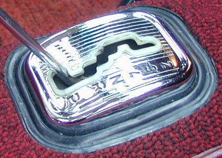

Does your Wilton Wool carpet have a black rubber piece of trim around the floor shift surround?
(The aftermarket carpets always use a piece of leather as trim.)
The original black rubber piece is (or was when I last checked) available separately, but nobody bothers to go to that length.
Here's the piece I'm referring to:
Download Attachment: shifter.JPG

Douglas:  The shifter surround is blue vinyl, still soft and supple as opposed to the binding on the rest of the carpet which while the same color and material is hard and brittle.(!?)  The original heel pad is gone of course.  This car has a blue leather dash with an incorrect stitched seam facing the occupants.  I suspect some time ago someone decided to change the interior color so covered the dash in leather and installed the carpet.  Too bad, but the carpet is quite nice an luxurious.
