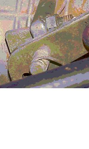

Thanks for your responses. I tried attaching a picture (this is my third attempt) I hope this works. It shows the position of the throttle flap shaft against the adjustment screw stop. I don't think that I can get it any closer then this. Even at this position, there is no resistence to opening the throttle. Looking into the throat of the venturi, it appears that there is clearance around the entire flap.
From experience I have concluded that the previous owners mechanic was not overly concerned in making sure that all of the parts he/she used belonged to a 280SL

Chuck, don't know if this will be helpful or not, but after re-reading your first post, I wonder if maybe there are two problems: too small throttle plate, and a blocked vacuum port.  You said you get no vacuum reading, but you should get a vacuum reading even with the throttle mis-adjusted or undersized, unless the vacuum port is blocked or in the wrong location (as it would be for engines with vacuum-advance distributors).  I suggest making sure the vacuum port is clear, and that the vacuum port hole is behind the throttle plate (i.e., on the manifold side of the plate).
I tried looking up a throttle plate part #, but that section is inconveniently missing in my parts manual.  I can only suggest contacting a dealership to see if they can find something, or used parts dealers to see if they can supply the entire venturi control unit for a reasonable price; they probably won't want to sell just the plate.

On my '65, the "throttle valve lever" is fastened to the "throttle valve pivot" by a pinch-clamp.  You can loosen this clamp, and re-adjust the position of the lever in relation to the throttle valve.
I am sure this is normally not meant to be adjusted, but in your case you have nothing to lose.  This will at least tell you whether you have the correct size throttle valve.  Who knows, if the previous owner wasn't that particular, perhaps he may have fiddled with it.
You may want to mark it first, so you can return it to the present position.

The whole venturi unit is easily removable. Maybe you should remove it and inspect it carefully. Try holding it up to the light and see if the flap is really not closing.

I just thought I'd update everyone with what I discovered. With snow on the ground and no place to go, I finally removed the venturi and checked it out. Will, you were right. Adjusting the pinch clamp on the valve pivot shaft did the trick. There was a line scratched on the shaft; evidence that a previous mechanic tried to get it right. He was just a little bit off.
I cleaned everything with carburator cleaner. The passage way to the vacuum port for the retard was plugged. I then adjusted the valve stop so that the valve just binds, re-installed the unit, and then adjusted the linkage shaft that attaches to the venturi. This I think should maintain the throttle linkage adjustments.
