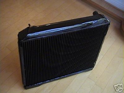

« Reply #16 on: February 05, 2005, 22:02:36 »

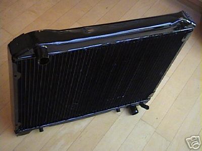

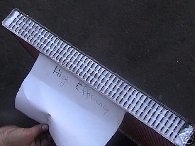

Here is some add'l info on the high eff radiator that I am going to install:
The HE radiator has three rows of new core tubes.
Each row has 47 tubes.  There is a total of 141 tubes
for the HE radiator.   Heat exchange fins are tightly
packed.   The new top and bottom tanks were duplicated
and molded from those of the original radiator and made with thick gauge material for durability.  No mercedes stamping number.  Two mounting 10 mm nuts on the right side for mounting to the body.  Four 8 mm nuts on the front corners for mounting of the fan
shroud.   Two through-hole bracket on the left side
for mounting of the oil cooler.  Radiator is painted with the standard radiator gloss black paint.  New transmission cooler  in the bottom tank.  New drain plug.
Download Attachment: radiator1.jpg
18.98 KB
Download Attachment: radiator2.jpg
19.39 KB
Download Attachment: radiatorcore.jpg
21.79 KB
Memphis, TN.
1997 E320

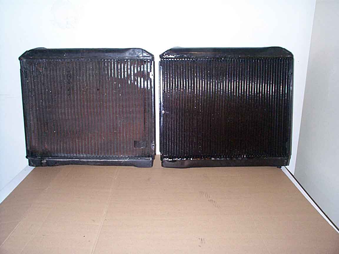

Update...

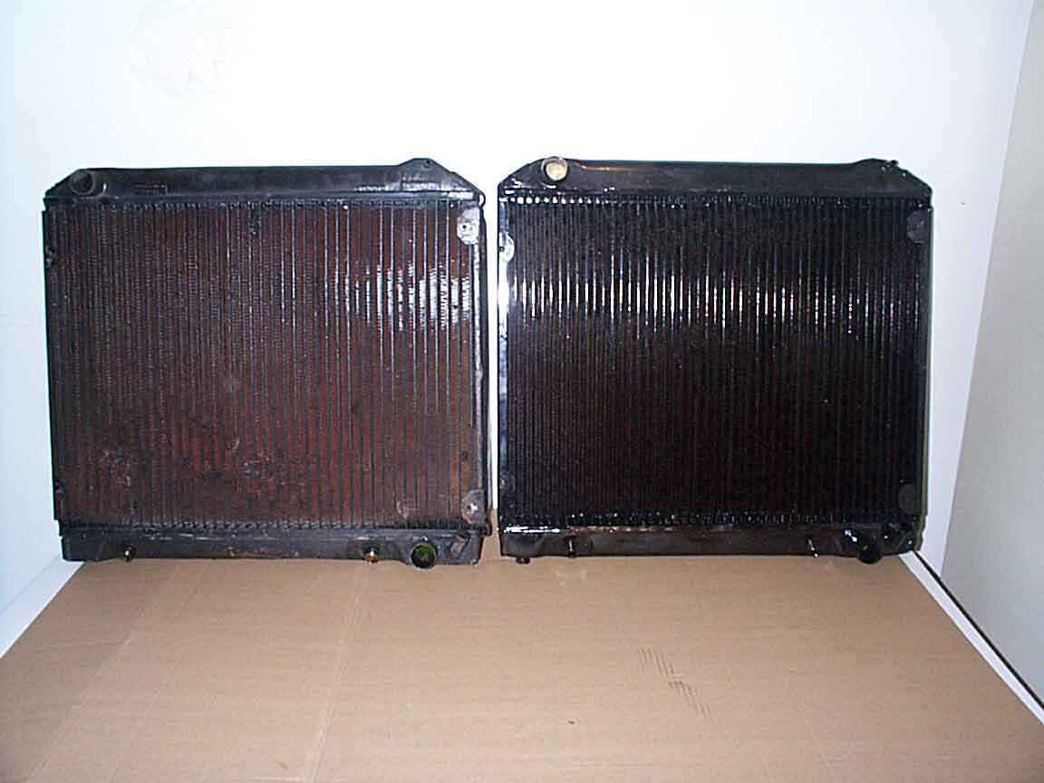

I received the after market high efficiency radiator today.  Attached are 2 pictures showing my old radiator next to the new one. One pic is the front side, one is the back side.  The new one looks virtually identical to the one I pulled from my car, it just doesn’t have any brand stamps, ie. BEHR.
Pulling the old radiator out was a bit of a challenge.  Taking the hood off was easy.  Followed the earlier posts, used painters tape around the edge of the car around the hood opening.  Used the metal hook off of a rubber bungee cord to hold the hood tension bar.  Removed the drivers side hinge while my son held the hood on the pass side.  With the one hinge removed, we simply slide the hood off.  I hope it goes on and lines up as easily…
Drained the radiator fluid and the oil cooler.   Disconnected all hoses.  Placed my jack under the radiator to hold it while I was removing the screws.  Had to completely remove the air cleaner housing in order to get to the lower radiator screw, pass side.  I though that I could leave the fan shroud connected and slide the entire radiator, oil cooler and fan shroud out, but the shroud caught on the lower fan blades.  Had to remove the screws on the fan shroud and push the shroud onto the fan, leaving it hang on the fan while I slide out the old radiator (oil cooler attached).  I then removed the fan shroud.
Now, lots of cleaning… and repainting of the oil cooler and fan shroud before I re-install all.
More to come….

Re: Radiator
« Reply #18 on: February 10, 2005, 19:58:10 »
Looking might good!  Is the standard radiator 2 rows?  What did the engineer tell you about what makes this one higher efficiency?
Re: Radiator
« Reply #19 on: February 10, 2005, 20:05:50 »
Hi Michael,
The engineer told me that this HE radiator has three rows of new core tubes. Each row has 47 tubes. There is a total of 141 tubes
for his HE radiator. Heat exchange fins are tightly
packed.  I believe our old, originals have only 2 rows?  This is from what I have read.
Memphis, TN.
1997 E320
« Last Edit: February 10, 2005, 20:06:15 by bpossel »

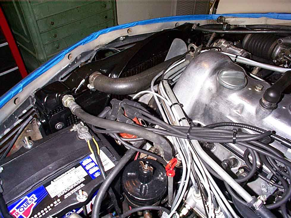

Radiator Update
Finished installing the new high eff radiator last night.  All looks good!  I ran the car at idle in the garage and the temp holds a very nice 179-180.  The real test will be when I drive in stop and go traffic.  I will update you on this when I do the complete "city drive" test.
I will post pics below... but first to summarize this after market high eff radiator...
My choice was to have my old radiator recored, or buy this after market one (new, original MB out of the question $$$).  To have a local shop recor would have cost about the same as this new after market one.  So I chose the later.
To summarize:
1. Cost - reasonable
2. Overall look - very close to original!
3. Paint quality - good, but paint seems to scratch off easy
4. Had to drill one of my fan shroud holes ~1/8 inch larger to make the shroud line up with all 4 bolts.
5. Had to rebend the small metal bracket that holds the top of the shroud to the radiator.  There was too much weld under the top lip that made the lip of the radiator not hold the bracket as designed.
6. Drain plug is on drivers side, vs original being on the pass side.  Also, drain plug no longer requires a washer.  Its a pressure fit type of plug.
7.  All hose connections went on the radiator perfectly!  No problems.
8.  All 4 bolts that hold the radiator to the chassis were perfect, no issues!
Here are some pics...

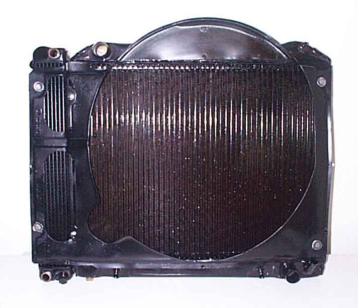

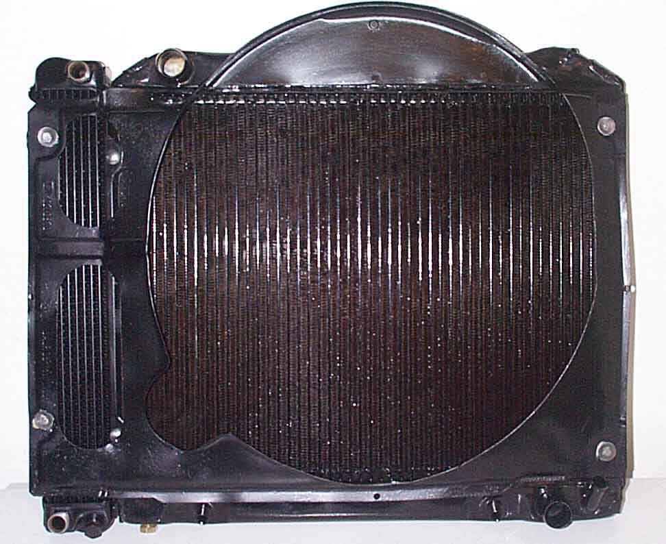

A. Complete radiator with oil cooler and fan shroud attached:
Download Attachment: radiatorback1.jpg
33.4 KB
Download Attachment: radiatorback2.jpg
65.3 KB
Download Attachment: radiatorfront.jpg
40.95 KB

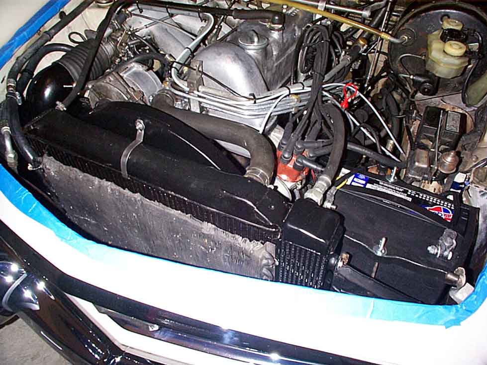

Here are some pics with the new radiator installed in the car.  Please excuse how badly mangled my air-conditioner coils are.  Not sure what has happened to this over the years?  Takes away from the nice look of the new radiator..  Oh well, this will be hidden by the hood...
More to come as I test drive the car in stop and go traffic.  This may not be until next weekend....

  • Posts: 7314
Re: Radiator
« Reply #23 on: February 14, 2005, 08:30:24 »
Thanks for being a pioneer in this area.  It has to be as good or better then what you have.
One item of concern for me is your comment on how easy the paint flakes off.  A bad paint job is often more useless then none at all!  Nothing will make your radiator look old quickly then to start having all the finish flaking off in the next few months as the car starts to be used.  Since you are this guy's customer now (the engineer who had it made) perhaps you have an in to get some questions answered, such as can this radiator stand up to powder coating?  What about these high-temperature powder coats--I think it is called jet hot?  What about getting it w/o paint, or perhaps changing the paint process?
