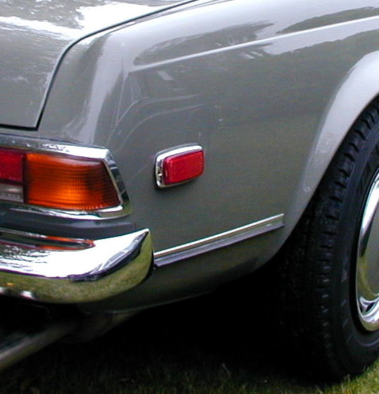

You're definitely right about the strip being aligned with the bottom of the rear bumper. The problem is that the panel bows out, so it's not optically straight when you look at it from the side. It has a slight angle.

Doug, thanks for the pics, which show the strips as they should look.  On mine, they seem to be at the right height at the front end but too low in the back, near the bumper.  Like everything else I've seen in pics of your car, yours look spot on.  What can i offer you to do some measurements for me?  Doesn't seem like a topic other people are particularly jazzed about!

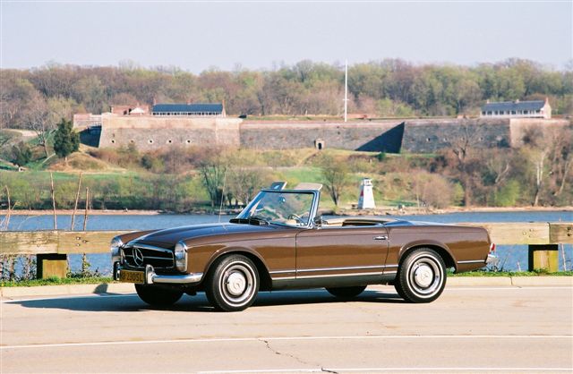

I've been hunting through some pictures of my Pagoda ot see if there is a good representative shot of how the rear trim strips should be aligned.  The trim strip should be aligned horizontally, so that it appears from the side to be a continuation of one horizontal line, from the rear of the front wheel arch straight through to the rear bumper.  The problem seems to be that when you view the car from a 3/4 front or rear view however (especially from substantially above!), the taper of the body tends to make it look like it is "off" somewhat.  The descriptions given by the other responders seem to cover the proper alignment.  Be aware that there is some play to the adjustment of the rear bumpers themselves, which are attached by only two bolts.  You might try removing your rear strips, making a chalk line with a builder's chalk string, and then aligning the bumpers to the line before resetting your rear strips.

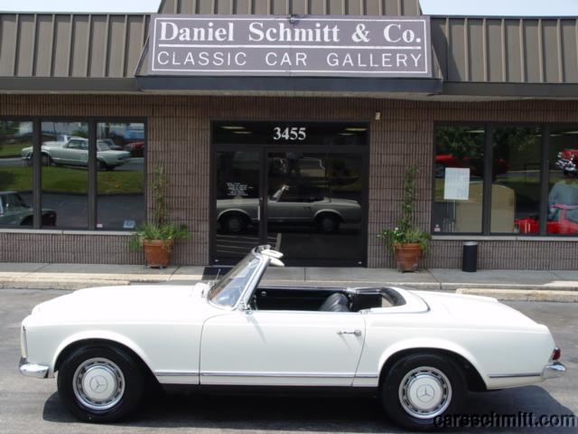

The photos you guys have pointed me to definitely show nicely aligned trim strips.  As I said, I mine seem to line up with the rear bumpers properly but nonetheless slope down towards the rear--probably because the bumpers hang marginally lower than they should.  I think the idea of using a builder's chalk line is my best bet for getting them straight.
I realize these disappear sometimes in the wake of body work.  Still,
it's a mystery to me why, when cars with intact strips get repainted, these don't get replaced precisely. Here's an example (worse than mine) from a pagoda on eBay right now, from dealer in St. Louis that has been the object of discussion on here before.  (Apologies to anyone with a personal connection to the car in question.)

The rear strip on this white car looks just about right, allowing for the angle of the picture and the camera lense used.  It is possible that you may be seeing somewhat of an optical illusion caused by the bottom edge of the fender rising up to the rear from the rear of the rear wheel arch.  It can make the trim strip seem to be not following the horizontal line from some angles.  Different body colors can affect how you perceive this illusion.  You and a friend might try using a length of string to eyeball the alignment of your rear strips relative to the front set.  If they are off, this should settle the matter for once and for all.  Then again, you might find that they are not as off as your mind's eye thinks!

I don't know, Mike.  Maybe you're right, but it really looks out of line to me.  Anyway, this is why, ideally, some objective criterion would be desirable, e.g. measuring from lower corners of the body panel behind the rear wheel.
