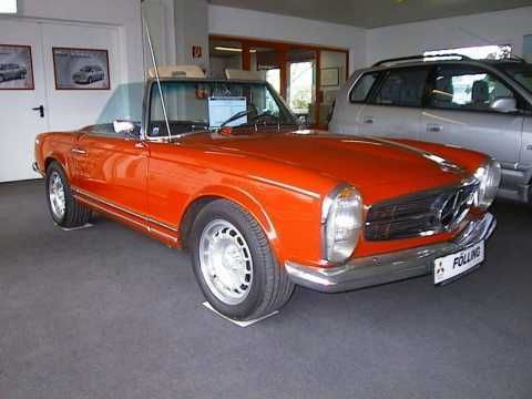

« Reply #3 on: January 22, 2005, 22:48:53 »
Here's a 113 with the 15' wheels.
Download Attachment: 280with 15inch wheels.jpg
27.63 KB

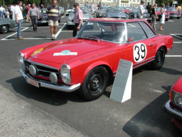

« Reply #8 on: January 23, 2005, 13:13:32 »
15 inch wheels as fitted to Classic Center 230SL Rally Replica.
Believe tyres were 185x15 Dunlop Sport ?8
Download Attachment: 230rally.JPG
52.48 KB
