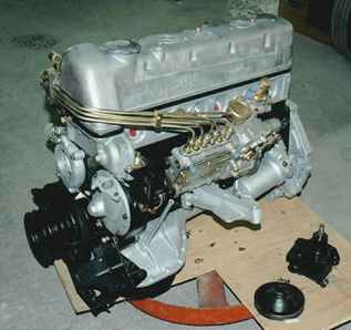

...as an added note, Metric Motors is one of the two premier engine rebuilders for Mercedes engines in the USA...the other being Noel's in Florida.  One on each coast--how convenient.  As I have a full Metric rebuild in my car, I'll echo the kind words about Mike Elias.  Their only business is engines, so they do it well.
http://www.mercedesengines.net/engines.html
http://www.noels.com/
