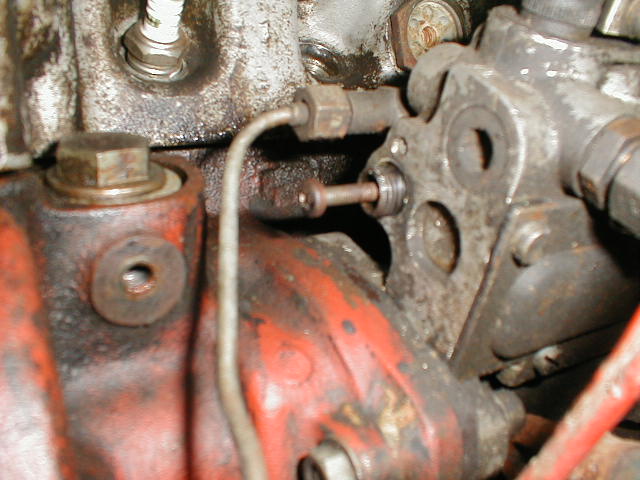

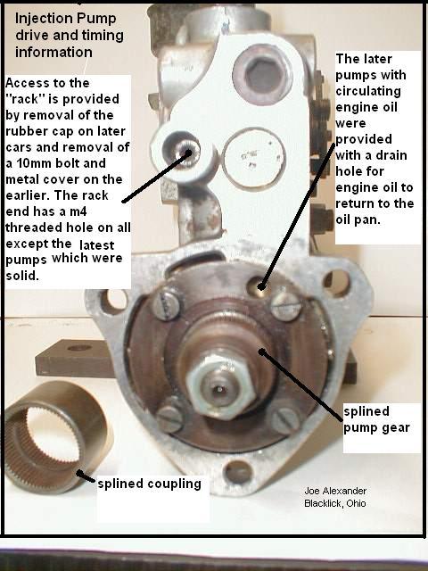

Assuming you have correct fuel pressure and volume going to the injection pump, you may have stuck rack on the injection pump. Remove the 10mm cap on the front end of the injection pump and make sure the rack moves freely in it's bore.
You can screw in a 4mm machine screw into the threaded end of the rack and check to see if it moves freely. It should also move slightly if the linkage going to injection pump is moved. The later injection pumps do not have a threaded hole in the end of the rack but all 230SL's should.
Download Attachment: 4mm screw on rack.jpg
60.62 KB
More details;
Download Attachment: injection pump drive end information.JPG
60.97 KB
« Last Edit: January 12, 2005, 17:43:38 by ja17 »
Re: dead 230SL fuel injection pump?
« Reply #8 on: January 12, 2005, 18:56:58 »
I believe the test screw should be a 5mm X 0.8 pitch.
 I use ones about 1-1/2" long. [ about 40mm]
 I have trid a few 4mm, but they were always too small.. possibly the early R11 pumps were 4mm ???
  • Posts: 7513
« Reply #9 on: January 12, 2005, 21:16:49 »
Hello ADalton,
You are probably correct on the 5mm, my memory failed me on this detail!
Joe
