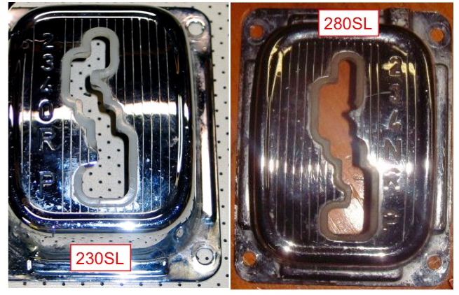

Flavio,
all automatic cars have consoles with the gear positions indicated, 230SL on the left, 280SL on the right and illuminated.
https://www.sl113.org/wiki/uploads/TransmissionClutch/AutoshifterConsoles.jpg
Thus, there is no need for the shifter ball having any numbers or symbols, only manual cars have balls with engraved shift patterns.

By the way : the only part that could be illuminated in my car is the nylon inlay of the shift gate because numbers and letters on the 230 are not transparent.  Are these transparemt on 250 and 280 cars?
Last 2 notes : 1) on a spare parts catalog I found an image where it seems that the bulb was present on 250 and 280 models and on 230 starting with 13333 VIN.
2) the nylon inlay is sold by MB in the 250 and 280 version only and it has small differences in the position of the slots through which the tabs fastening the insert on the metal gate pass.

« Reply #4 on: July 19, 2017, 00:46:50 »
The later style is transparent where the characters are so you see the illuminated plastic thing. I don't think you can use the late plastic insert in the early shift gate, but I might be wrong.  The later plastic thing has tabs where the light snaps into place and where there is a cable hold down for the light.  The early one wouldn't have that.  But you can switch from one to the other.  And I have some on ebay for sale.

« Reply #5 on: July 19, 2017, 03:19:39 »
With a bit of effort you can put a late plastic insert into a 230SL console but not the other way around.
It appears that nobody is looking at the photos and/or reading the text in the technical manual. I wonder why?
https://www.sl113.org/wiki/TransmissionClutch/Shifter#Auto_ShiftGate

Thanks Alfred.
Yes, with a little effort, a new slot and an excavation on the other side were enough to fit the last nylon guide on my 230.
We had 2 options and at last we used the MB original guide that fit perfectly with little adaptations.
As you can see, the early 230 had only 4 tabs.
