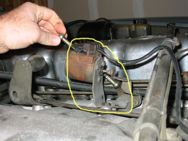

Here is a picture of the "middle rod".
How is the length of this rod set?
Thanks!

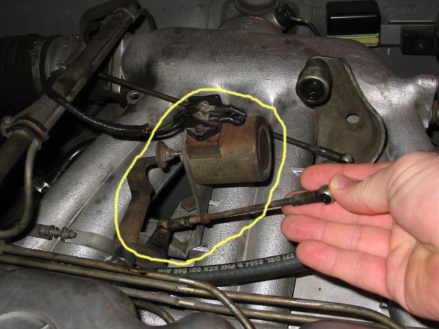

Great pic!  I've never done this (adjust my linkages), but I believe the length is adjusted by spinning the end socket connectors.  They are threadded on and should screw on/off to get shorter/longer.  May require penatrating oil or PB Blaster (www.blasterchemical.com/store) type treatment.  This rod on my 1966 230SL currently measures exactly 6 inches (153mm).

I notice that your constant speed solenoid is "behind" this rod.  On my car, an automatic with no A/C, this rod is connected to a hinged bracket and the solenoid is on a fixed bracket.  This hinged bracket gets pushed forward (toward the radiator) by the arm that extends out of the solenoid when I put my car in gear.  This moves all the attached linkage which adds some fuel and air to the engine.  This is to maintain RPM when putting the automatic into gear and holding the brake.  An engine under load needs more air & fuel to maintain the RPM.

Looking at your picture again, I can see your solenoid is connected to the end bracket for the main cross linkage bar and it must be pushing on the same part that connects the linkage to the venturi unit.  This would product the same effect.

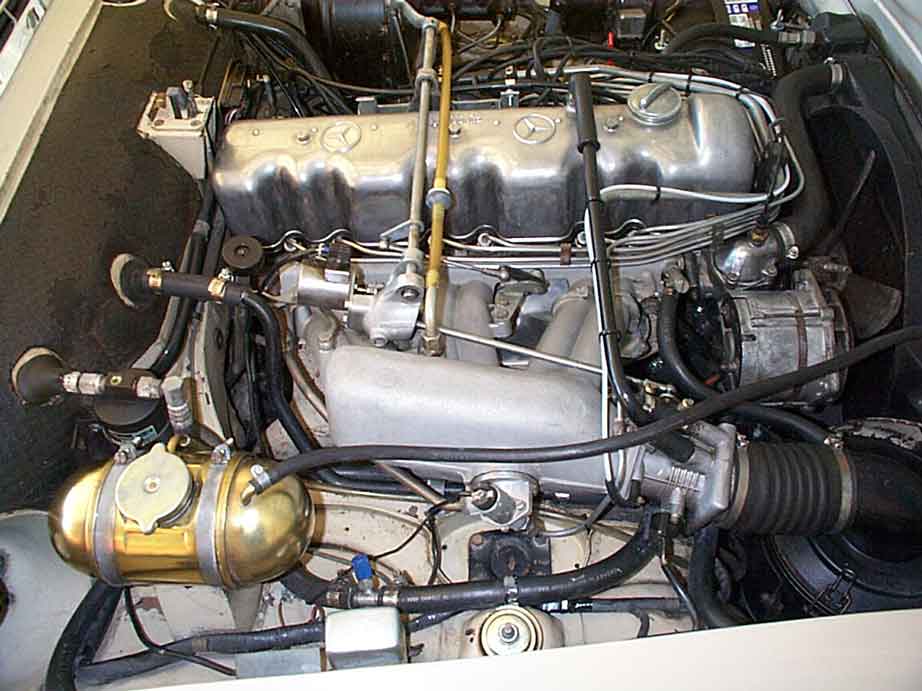

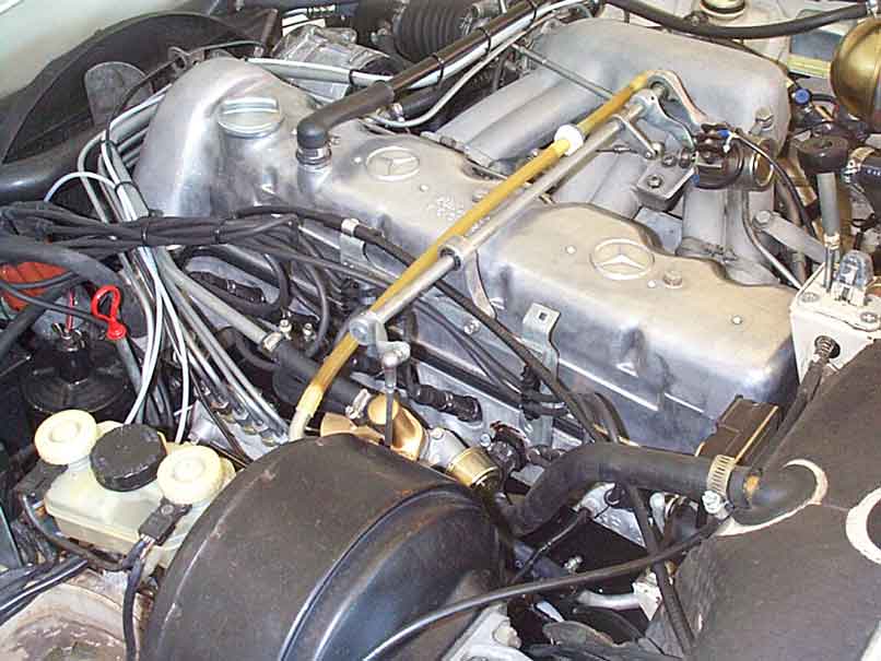

Hi Rodd,
You have a question in your post about the pipe that runs with my white (now yellow) vacuum hose...  Not sure which pipe you mean?  What is running along side my vacuum hose is the main throttle linkage rod (as seen on pic, left of the vacuum).  To the right is the oil breather hose, with small vacuum hose...
Does this answer your question?  If not, happy to answer any others.
A couple more pics attached.
Download Attachment: Copy of Pic 038.jpg
77.39 KB
Download Attachment: Copy of Pic 042.jpg
80.12 KB
Looking at the details of your engine, we have several differences.  It's amazing what changed between a 127 and 130 engine:
- location the brake booster line connects to manifold
- style of idle air screw
- mounting of constant speed solenoid
- style of venturi unit
- what is the pipe that runs with the white vacuum hose?
- different oil filler cap
- you have some sensor connected to the top of your thermostat housing
Download Attachment: engine-2.jpg
60.17 KB
Download Attachment: engine-3.jpg
52.8 KB

I think Rodd is talking about the pipe running along with the white (small dia.) vacuum pipe to the distributor vacuum retard unit??
Rodd,
Its one of the hot water circulating pipes to the throttle body. Its takes (I think) water to the top of the t/stat on the FI pump. The water inlet pipe to the throttle body comes from the engine thermostat housing.
Early 230s do not have this, while 250s have a coil running in front of the throttle body. 280s have it integral with the throttle body.
