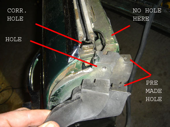

I am replacing the door seals and have a question:
How is the top aft seal end secured to the door?
On the old seal there is a screw in the middle of the seal end with a corresponding hole in a metal lip behind. On the new seal there is no hole. Should I make one and secure it here?
On both the old and new seals there are a hole all the way to the right in the picture which looks like a nice position to secure it – but there is no corresponding hole in the door. Should I drill a hole?
Download Attachment: door seal.jpg
80.21 KB
Per G. Birkeland
69 280 sl aut 834
Norway

Hey Knirk. Just looked at my door seals. Not sure how this helps but my drivers side has a screw (squarely in middle section) and my passenger side has no hole or screw.
I am pretty sure I replaced these seals with OEMs somewhere along the way.
knirk
Re: window & door seals
« Reply #13 on: June 14, 2005, 23:58:59 »
Thanks James, I will use the center screw. I fiddled with it yesterday and it seems that the seal needs to be secured here to get a tight fit.

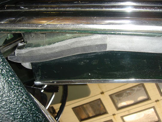

Download Attachment: door lip.jpg
78.49 KB
Per G. Birkeland
69 280 sl aut 834
Norway
« Reply #16 on: June 15, 2005, 15:42:11 »
Thanx Per,
