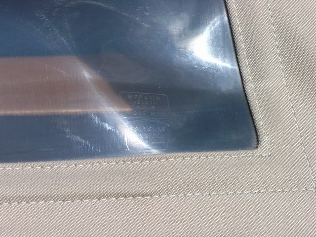

Quote
Originally posted by Hervé Lepissier
I do believe that I have a original soft Top, the incription embossed onto the rear plastic window, situated on the bottom right corner of the rear windscreen is :
WOPAVIN
- 9101 -
AS - 6
GHE M1
Then :
POLYGLAS
~~~D 24
____ 1 ____
see attached
Hervé
280SL 1969
Download Attachment: Pagoda softtop label1.JPG
55.03 KB
« Last Edit: November 29, 2004, 07:04:34 by n/a »
Re: New soft tops
« Reply #19 on: November 29, 2004, 07:08:59 »
Herve: Yes, that's an original top.
Tom: Impressed with your selection of soft tops on your website. Can you also get 7015 Dark Gray? I noticed you offer 7016 Light Gray.
