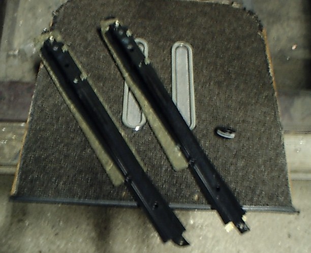

If they do not come out: Some of the
sticks inside the backrest have points
which have to be pressed to uninstall
the headrest.
see picture:
Download Attachment: headrest sticks.jpg
79.69 KB
Good Luck !

Thanks PagodeInfo; indeed I had to take the seat back cover off, loosen the 2 vertical strips that guide the headrest rods and press a release button on one of the strips before the whole headrest would come off; you can't just pull them out all the way.
