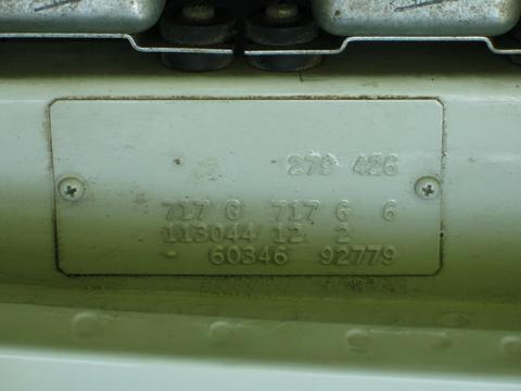

« Reply #5 on: November 05, 2004, 07:36:36 »
what color should the serial plate on the left fender be?

« Reply #6 on: November 05, 2004, 08:28:23 »
Also body color
Here's an example from a Papyrus white car:
