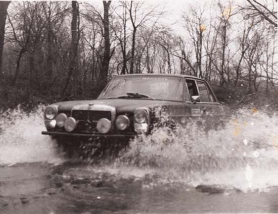

Hello waqas,
Thanks, I never thought this information and knowledge would be of much use these days until I found you guys. Many of you have become experts also from all the information available here. I always learn something myself.
Don't get me started on Rallying, we will be here all night!
Download Attachment: CREEK.jpg
44.49 KB
As far as overfilling of oil; I am sure there is a slight margin of error for allowing for slightly overfilling. I would suspect about a pint.
Gross overfilling will cause the crankshaft to beat the oil into a froth (like egg nog). When the oil foams the oil pump will pick up the air/oil mix which will not properly lubricate and will decrease oil pressure.
« Last Edit: October 25, 2004, 18:39:26 by ja17 »

J.A.,
 Is that a 114/115 ??
Tnx
  • Posts: 7517
Re: POLL: How's your oil consumption?
« Reply #20 on: October 25, 2004, 20:49:39 »
Hello ADalton,
Yes, a 1968 250/8 (W114)with a 280-SL engine, 4spd, lightened to about 2200 lbs.

JA
 That's Great ...
 I owned a 114 for many yrs. A 1971 250 with the 2.8 M130 carb engine and I must say that it was the best Benz I have yet to own...
SOLID car..Everyone keeps them until the  heater blower craps out... they built the chassis around that .
 ..and real MB/TEX .. you still see them in the scrap yards , rotted to the roof, but still  perfect seats ..b/g..
