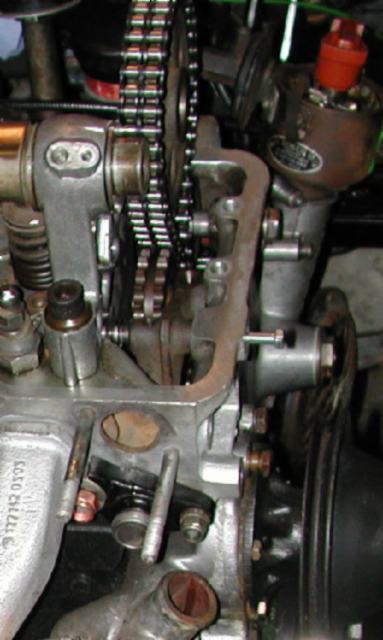

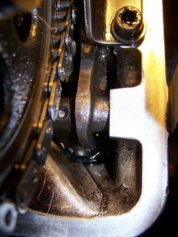

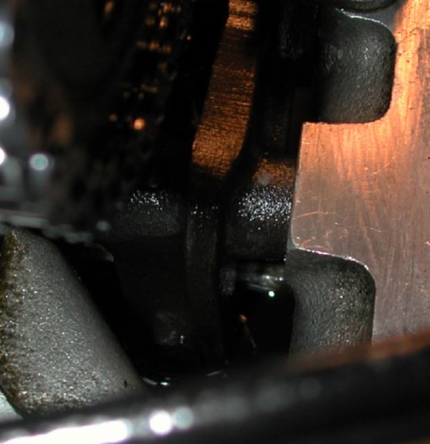

I still do not find the bolt under the chain tensioner.  Can the tensioner just be moved enough?  Does the chain guide bracket need to be moved at all?
Download Attachment: tensioner.jpg
28.53 KB
In the above picture I have not removed any of the oil "behind the dam" should have more than what appears in the picture?  The reason I ask is that the chain next to the guide can be moved about 10 cm.  Maybe the tensioner is losing its oil pressure or sometime.  The car has been sitting for about two weeks.

To Tuultyme:
From the photographs it looks like your engine is different than mine. In your picture there is no dam and no bolt. I don't have an answer.

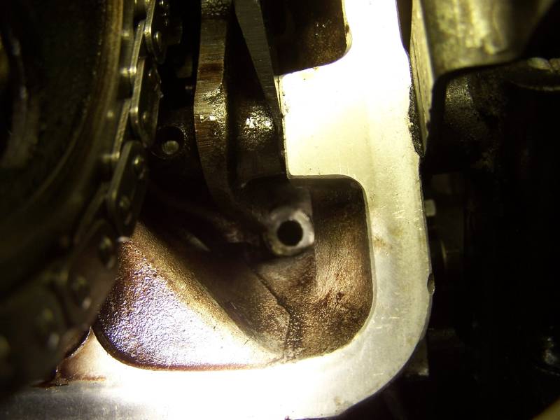

Can anyone explain to me how to get to the bolt under the chain tensioner so that I can "reseal" it?  see picture.  Do I need to remove the tensioner?

I guess I do mean 10mm.  Hopefully the oil is leaking out the bolt hole that I am tring to find under the chain tensioner.  Is it fairly easy to take off the chain tensioner and how will its removal affect the timing chain once I put it back on?  Hopefully I am going somewhere which is not too difficult.

Hello Bruce,
You can force the tensioner sprocket rearward on it's pivot pin enough to get the long leg of a 6mm allen wrench into the bolt head.

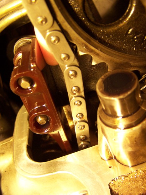

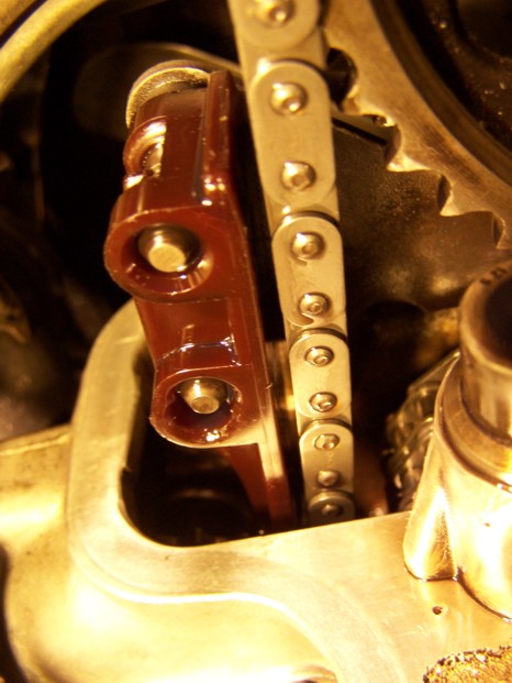

Bruce,
Maybe these two photos (self-explanatory??) will help:

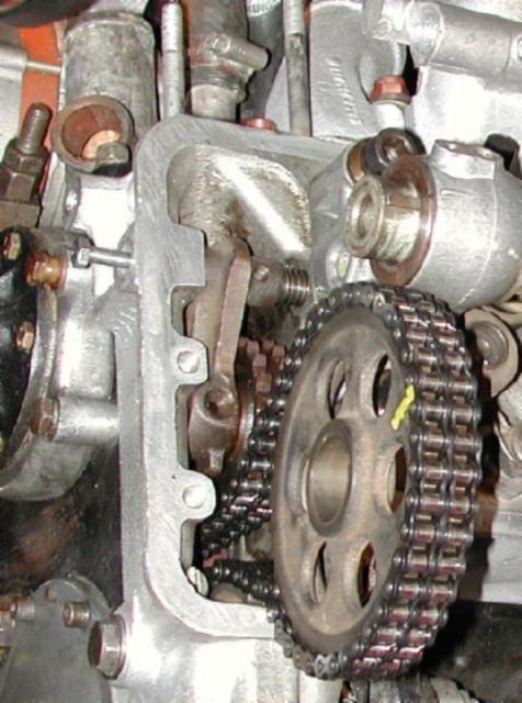

« Reply #15 on: December 30, 2004, 19:01:46 »
I used some rags and removed the oil from the "dam" under the tensioner and found the Bolt!
Download Attachment: tensioner bolt.JPG
31.52 KB
Removed it, it was fairly loose and put sealer on it and reinstalled.
Download Attachment: tensioner bolt 2.jpg
56.43 KB
Got the car back together and took a short run around the block;  now to see if the leak is fixed; may have to wait till spring.  Now onto the next project.
