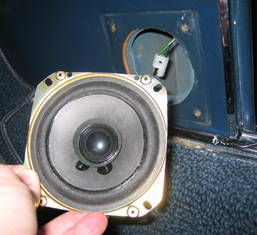

The photo attached below is of the speaker found in my dash. It appears to have 2 small tweeters as well as the larger center cone. Anyone recognize this? Could this be original or is it an obvious later conversion?

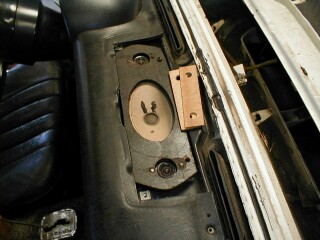

Ed, I have never seen a center speaker like yours before.  None of these had tweeters.  I have a Europa II stereo in my car with  center and rear speakers.  My fader switch is located in the center console where a defroster switch would be.
I will try to post a couple pics for you.

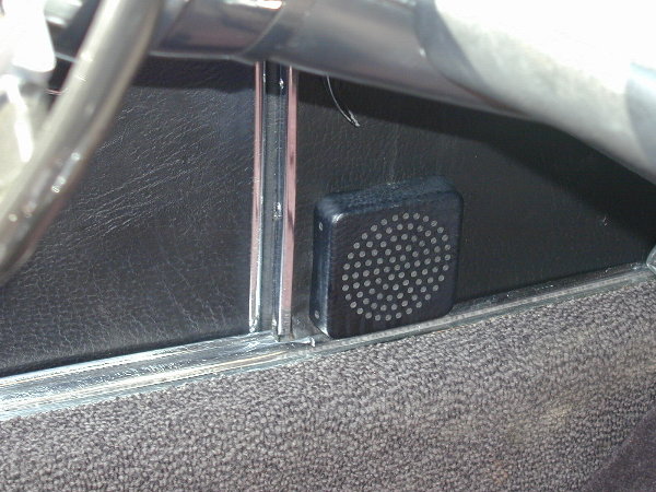

Here's a photo of a factory speaker in a kick panel. It's identical to mine:
Download Attachment: frtspkrs.JPG
82.48 KB

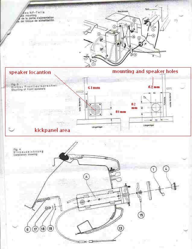

I also have the Becker installation diagram for the radio and the stereo speakers with the exact locations on each side.
Download Attachment: speaker panel layout 2.JPG
58.8 KB
Download Attachment: w113 speaker1.JPG
52.85 KB
Yes the center speaker was left out when equiped with the stereo and dual speakers.

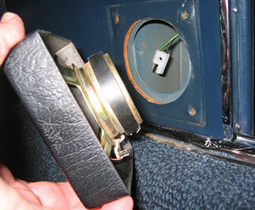

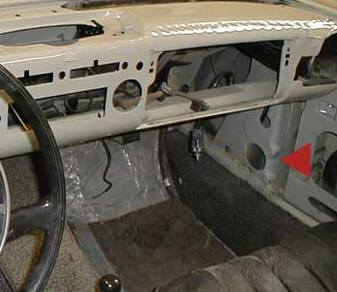

Well, I'm kind of back to square one with my speaker issue and need some help. The photo shows the factory cut hole where the original kick panel speaker(s) would be installed. Can someone who knows these speakers tell me how large a speaker this hole will accept (3- 1/2", 5-1/4"?) and is it possible to use the original square black plastic grill with a modern speaker (of some size) behind it?
Douglas posted a photo of one of these speakers in his response below and the overall size of it appears quite small. Anyone know the width x height dimension of one of these?
Thanks in advance for any help you can offer.

33.08 KB
Anyone know when these speaker spaces first showed up in production?  I assume my 230SL would not have them.

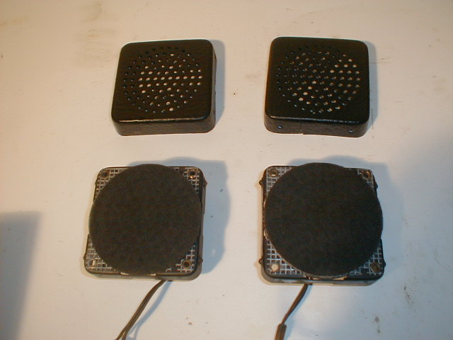

I have a pair of these originals in front of me.
The plastic covers are 4" X 4" and 1" deep. The 2 1/2" diameter speaker magnet is the only part of the speaker which protrudes 3/4" out the back of the cover.

« Reply #12 on: January 13, 2005, 22:47:06 »
Hello Rodd,
The openings were probably "hole sawed" at the factory if the stereo option was ordered.

I'm using a pair of small Pioneer speakers (4x4 after a slight modification to the speaker frame). They fit snuggly into the black kick pannel speaker box.  The depth is just right so only the magnet extends through the hole in the body.
Download Attachment: speaker 1.jpg
71.89 KB
Download Attachment: speaker 2.jpg
68.65 KB

JA17 - This car came with the mono Europa and has never had speakers installed in the kick panels. From what I understand, these holes in the steel became a standard at some point, regardless of whether speakers would be installed there or not so all 'later' cars would have them. From what I've seen in my research, a fairly low percentage of cars ever had speakers installed there.

Yes the stereo option  is fairly rare and the speakers hard to come by.
Interesting, so a lot of late 280-SL's have these holes behind there kick panels.
