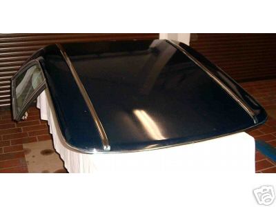

I also want to restore mine. I heard the side windows are very hard to deal with as wel as the side handlles to fix the roof. If you happen to find the article mentioned here I would be happy to get a copy of it. Good luck wth your restoration, Paul.Included a picture of mine.
Download Attachment: cf_1.jpg
15.06 KB
