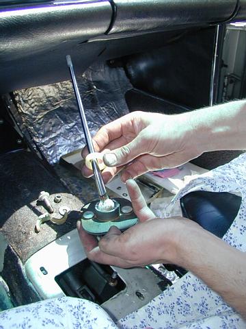

will is correct. in fact, achim & i recently changed my shifter bushings.
i ordered a set of new bushings from my friendly dealer for roughly $25. it's a once-every-30-years kind of repair and should take a professional roughly an hour. it's somewhat tedious, but straightforward.
below is a photo of the disassembled shifter:
#018260
Download Attachment: bushing.jpg
37.92 KB
