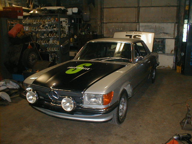

I have entered my prepared 450-SLC in the competition class :)
Download Attachment: Rally car.JPG
62.02 KB
Vintage events like this are several times a year and are becoming vey popular.
