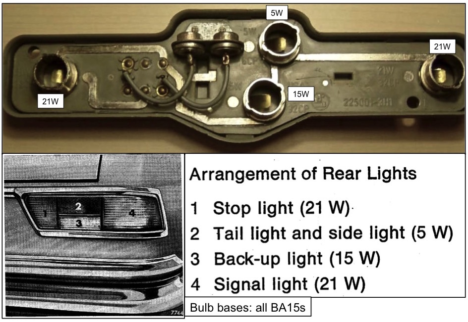

Looking around the site, it seems that there's no single spot for external LED bulb upgrades - there's posts going back to 2008 on upgrades but nothing regarding LEDs in the tech manual.
If anyone has any more up to date/LED info that can be added to the below, please post copy/paste the relevant line and upgrades they've used. Any other modifications that might be required (eg relays) would be useful. As Jameshoward says, this increasingly a matter of safety (and not getting our valuable cars shunted)
Fronts (euro) - from tech manual
    The main Headlight bulb is a 40/45 watt non-halogen (Bilux) bulb that can be upgraded today. The correct replacement therefore carries the designation "Halogen BILUX-AS-HALOROAD R2 12V P45t" (available from Osram or Philips) and is a special 45/40 watt halogen substitue for greater light output and longer life. It's very similar to the regular (European) 60/55 watt H4 halogen bulbs but with a slightly lower output (barely visible) and with the correct P45t socket for the old-style mirrors used on the W113s. The bulb has three projecting connectors to fit the car’s internal connector.
    The Parking Light is a miniature bayonet bulb T4W on a BA9s base. An upgrade is available as 3886X to give more light. Replacements include: 3893, 57, 57X, 1891, 1893, 1895, 78223.
    The 18 Watt Turn Signal bulb can be upgraded to a P3497 higher intensity bulb.
    The Fog Light bulb is a 35 watt bulb on a BA20s base.
    The Night Light (Clearance) bulb is a 3 Watt bulb on a BA-15s base. An upgrade is available to a more modern R5W bulb.
Rears (230) - can anyone clarify if the holders are the same for the later cars? Tech Manual has both clusters and they look very different but no clarity on the actual bulbs/holders)
    Brake light: 18W / Base: BA15s
    Tail light: 4W / Base: BA9s
    Parking/clearance light: 4W / Base: BA9s
    Back-up light: 15W / Base: BA15s
    Turn signal: 18W / Base: BA15s
James,
not sure whether I understand your question. On 230SL cars there was only one type of bulb holder. The same holder was also used on 250SL and on early 280SL. Later 280SL holders (with the introduction of the amber turn signal lens) had two diodes incorporated and all four bulb bases were the same (BA15s).
It is all here: https://www.sl113.org/wiki/Electrical/TailLights
I haven't added any info on LED bulbs because there availability and quality is changing almost monthly. However, it is easy to search for possible LED bulbs using the bulb base as search function. But keep in mind that LED in the turn signal position require a LED relay!

Thanks Alfred - are the holders/clusters the same configuration across all the cars? ie, same bulb (size/holder) pointing the same way?
What do you mean with clusters/holders? These parts: https://www.sl113.org/wiki/uploads/Electrical/Tail_Light_280SL.jpg ??  ???
