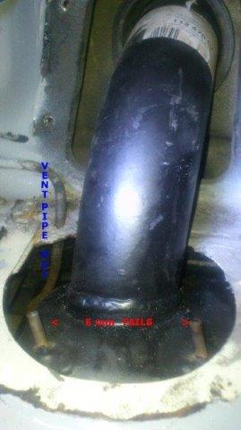

I drove home to realize I was now looking at a major volume of fuel leaking from a return pipe from the canister that leads to the underside of the car (and that looks like it should have a hose attached to it, but no hose at all  ???  - I'll see if I can upload a picture shortly). I also noticed the canister was making a bubbling/gurgling sound with the engine running. I pulled it and cleaned/blew it off, put it back in place and still see the same issue when the engine is running. By now it was 9 pm and I had not been out of the vapor filled garage for more than a couple hours, so I figured I'd try it on Sunday.

Hoses were fine. I had replaced these when I bought the car about 7 years ago and used internally braided fuel injection hoses... Clamps were firm in place as well. No blockage on any of the three pipes.  However, one of the two small inlets to the tank (the one on the right side of the picture below - from the Tech Manual) is absolutely blocked.
I applied all 125 PSI of air pressure from my home air compressor, but it would not come unblocked. The one on the left side of the pic (it's on the right hand side of the car) allowed airflow into the tank with ease, and flow could be felt placing my hand on the fill hole to the tank. I also put pressure from the fill hole to see if I could drive pressure from the opposite end, but still would not budge.
I was thinking I might try to drive something in there to unblock this passage, but I'm not sure what to use. I did not have anything in my arsenal that was thin enough to go thru yet strong enough to push thru a sturdy blockage.
Has anyone encountered this type of issue? What have you used to unblock?
