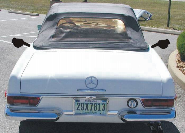

If I may add to the questions here, it seems I remember Cees had a tip for keeping the soft top from riding up on the corners (see attachment) which I've always thought hurt a 113's appearance. Cees, can you or others give a detailed response to eliminating this common occurence?

Hi Ed. Actually getting the corners to stay down is fairly simple. As you are putting the top down, have a close look at how the corners get folded in, into the soft-top well; there is a small ridge in the well that forces the corners UP. Not a smart place for those ridges, but from memory they could be necessary to accomodate the tires or some other part of the car's sub-structure.
Anyway, what you want to do is fold the canvas DOWN with your fingers as the top is reclining into the well, on both sides. You fold the material underneath the frame as it's going into the well. Richard Madison mentioned that he made 'shoe horns' out of some sort of plastic to make this process easier (it can be hard on your knuckles - but it's worth it).
I learnt this tip off the Yahoo! site about three years ago. After years of having the edges curled up, after only one week in the well folded down this way, the corners 'behaved' perfectly and fit nice and snug to the car body.

Cees, I am testing your theory ;) .  A few days ago after reading one of your posts I decided to try it myself.  I wonder if Richard Madison  would post a picture of his "shoe horn" tool :?:   I also have plastic covers on my springs made from an oil container.  :D
