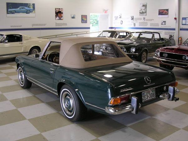

Re: Removing the Bumper Guards
« Reply #12 on: September 29, 2004, 15:06:15 »
The later style bumper guards are not that bad looking considering what the early style looks like.
« Reply #13 on: September 29, 2004, 15:15:33 »
These early style guards look like something Volvo ("converted tanks") might have designed! Ouch.
p.s. nice 'Stangs in the background there.
« Last Edit: September 29, 2004, 15:16:35 by cees klumper »
« Reply #14 on: September 29, 2004, 17:57:56 »
Three out of four are Shelbys.  I couldn't see enough of the beige 64/65/66 convertible in the corner to tell what version it was...
