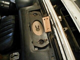

Since there is some discussion on the front speaker I thought I would bring this up.  In a recent topic by Ed Cave "280sl Restoration Underway" his project car's center speaker has tweeters on each side of the center speaker.  I have never seen this before.  Does anyone have any idea if this might have been an upgrade?  Or could this be a custom job?
Download Attachment: center speaker.jpg
19.88 KB
Re: What's underneath the wooden speaker cover?
« Reply #13 on: September 23, 2004, 21:45:56 »
I believe that piece sandwiched in the rear deck lid was originally foam, not felt.
Can't comment on the tweeters in the front speaker. I know the speaker itself is still available from Becker, so I'd ask Ed Ebel at Becker USA in NJ.
I would assume it's custom because of what appears to be a wood frame to hold the 3 speakers and the two wood spacers to make it fit right.  I can't imagine Becker producing anything so "amature".
graphic66
« Reply #16 on: September 24, 2004, 08:02:42 »
I don't know about the speaker but the two spacers support the dash wood. they are just a couple of pieces of masonite and do look very "not SL PC". They are in my car and just support the dash wood.
