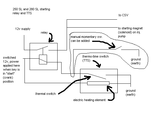

The cold start relay circuit is completed through the Thermo-time switch to ground [ switched ground]
 The feed for the relay is through the starter portion of the ignition switch, so it will only be energized in the start position.
 If one grounds the 'W" terminal on the TTS and the cold start works [ test lamp helps here] , then the TTS is suspect.
 Many users run a ground wire from this terminal to a swiched ground push button, momentary ON, in the cabin... kind of like the old manual choke, but electic...with this set-up, you are the TTS...advantage to this is you can operate the cold start squirter at will and as long as needed,[ only at crank], regardless of engine temp...
..like , when it won't start cuz it's hot [ common fault after sitting for 20 min...]
 Other plus is you do not have to worry about flooding fuel to engine when using the  starter  to turn engine over when doing valve adjust, dwell, and other repairs that require engine cranking w/ignition sw....

<<<The more I thought about it I wondered if the thermal switch was actually two switches in one housing. After removing both wires (one pink, the other pink/green) and ohming the terminals, I noticed one was 'grounded' and the other had resistance. >>
 The switch is a thermal heater activated switch..The terminal with the resistance - [term G ]is a heater wound around a bi-metal type switch and completes to ground internally. . When it heats up, it causes the "W" terminal to open ..
[ the W terminal is normaly closed to ground when temp is less than 35C].  The time it takes to open is from 2-12 secs., depending on coolant temp .  [ a test for time calibration is it should open on a bench test at room temp of 20C in 5 secs when energized w/12v.]
 Anyway, this is the TTS and it is the switched ground for the Squirter [CSV] relay primary circuit. As in my previous post , if one wants to check the integrity of the CSV circuit, he may simply ground the W terminal at the TTS . That will complete the circuit to energize the relay coil, which in turn closes the relay contactor
[ load side of relay] to get 12v to the CSV via fuse #6. Because the start switch is in series with the circuit , the CSV will only work when the key is at start position. So, if the CSV works when grounding W , you know that the CSV,relay, and feed 12v are all OK, but the TTS is open. But is it open due to temp or is it shot? That is where the time/temp test comes in ..many still work, but cut-out prematurely ..ie too low a temp......
 I do not have color codes for the wires , but the W term will feed back to the relay term #85 and the G term will go to #86, so you can check that out via continuity for proper polarity..[pins 30 and 87 are the relay contactor/sw terminals]..
 You have the late style pump and they eliminated the starting solinoid that moved the rack foward for start assist , regardless of temp. So, on pumps without that feature , one can accomplish the foward movement of the rack by using the excelerator pedal...
 The reason guys run a ground sw in the cabin from the W terminal is because once the TTS excedes the temp spec, the CSV will not work.. but one can trump that with a little squirt.
 On a pump that has sat for an extended period, the ball valves leak back and the car will not start when warm, so the button will overcome this. I have seen many clear up after running/reseating for a while.
 { there was actually a Kit one could add that would energize the squirter fo 1-2 secs, regardless of engine temp, because of warm start problems with pump without the the extra solinoid]
 Anyway, there are other sensors and relay, but this is the basic CSV circuit..
PS ..the other pump solinoid is to bring the pump rack back to full lean status, an emmission device.

 Well.. you then are sensing ambient temp and that is not what they are trying to accomplish .. the reason for coolant temp sensing is b/c all the other FI pump parameters are coolant temp sensed and are designed into the balance of fuel operations. [ ie.. you want all sensing inputs to be rom the same source]
 What I would do is to check and see if the TTS is switching at 35C as intended.[ bench test/previous test]
Bear in mind that Benz had designed the system to not need a shot from CSV once that coolant temp was reached for starting , but the pump before your [R22s] , also had a starting aide rack solinoid
that worked regardless of temp [ in other words , anytime the key was at start].
  So , they should start above 35C without help of the squirter [ CVS
slang for practicality] , but that means with  a perfectly trimed out a/f  pump, timing , etc ..
 Again, a cabin squirter to groung W works anytime you need it , but does not change anything in the system,b/c if you do not use it , the stock system is still there..

The attached diagram shows the relay, TTS and CSV.  Late 280 SLs (70 and 71) don't have the starting magnet shown upper right, otherwise should be the same.  230 SLs are similar but not identical.  The circuit inside the "balloon" is not stock, but is easily added to give you control over operation of the CSV (as described by ADalton).
Download Attachment: CSV_relay_TTS.bmp
