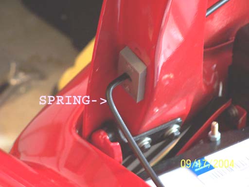

On the left side right near the battery is a stiff spring that rides in a plastic track.  The spring actually goes across the entire forward part of the bonnet.  See photos. I believe the block is available new as well as the strap, as both of mine had been replaced in restoration.
Download Attachment: Block.jpg
44.55 KB
Download Attachment: Spring.jpg
37.56 KB

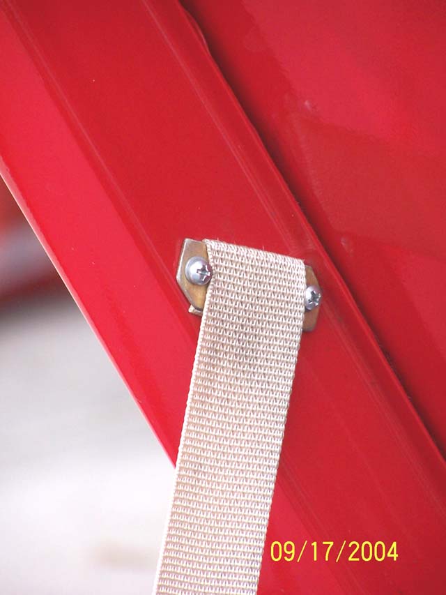

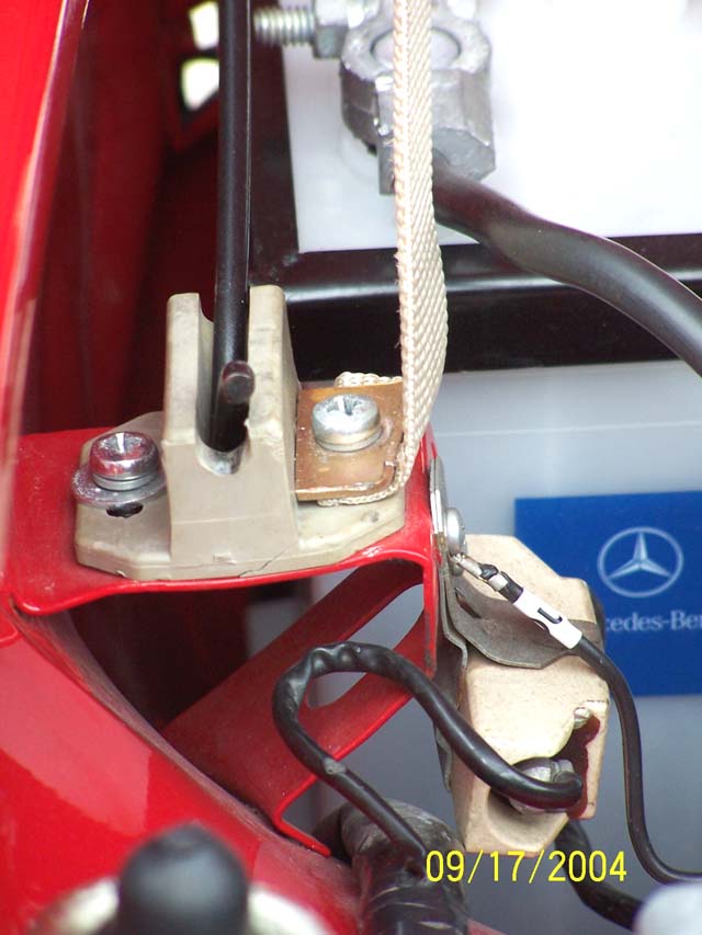

Would you be willing to take another photo that shows how the hood strap is attached. My '63 doesn't have one -- but I might add it.

For Jim Huber and those interested here are photos of the strap and its two mounting points:
Download Attachment: strap1.jpg
62.62 KB
Download Attachment: strap2.jpg
78.24 KB
Download Attachment: strap3.jpg
77.57 KB
Re: Bonnet (hood)
« Reply #5 on: September 17, 2004, 16:00:46 »
Many Thanks Mike. Great pics. It appears I will need the strap, the brass brackets, & the upper screws. It's officially on "the list."
