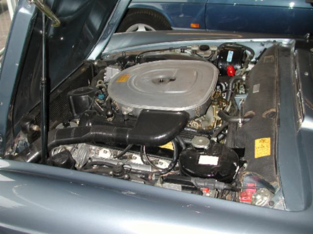

Have a look at this
http://www.sl113.org/forums/uploaded/naj/200441944718_V8_5002.JPG
Its a late all alloy V* from a 500.
Was told it weighs less than the 230sl straight 6 it replaced.
