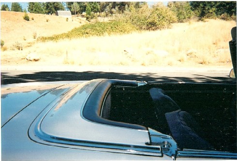

Actually no that's not what I was referng to. Although I do have that strip as well. In my case, the chrome strip is screwed into the cloth covered bow. I don't think it moves.
Now, the chrome piece I was refering to is visible with top down. It runs just behind the leather or MB Tex pad on top of topcase.
.......This is at the rearmost part of the soft top lid ??  I have never seen a 113 without this part, it comes all the way artound to the edges where it meets the chrome end pieces right ?

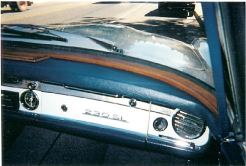

Does anyone else's '64 have the painted end pieces on the dash where the round chrome vents are? Most I see are chrome but I never found a reference for when they changed !

Well Naj, I am not really sure. I did manage a picture of the "top case" chrome strip ... not to be confused with any chrome on the soft-top itself... Here goes:
Download Attachment: chrome.jpg
55.26 KB
PS we are looking at the chrome immediately behind upholstered pad...
« Last Edit: September 10, 2004, 12:36:09 by J. Huber »

And Ben, not to forget your question: my car has the painted vents ... I believe later cars went to all chrome.
This photo also reveals my dashwood which I would characterize as somewhere between light and dark...
Download Attachment: dashwood.jpg
54.85 KB

Hey James,
My early 250 does NOT have that chrome trim piece on the soft top cover.
