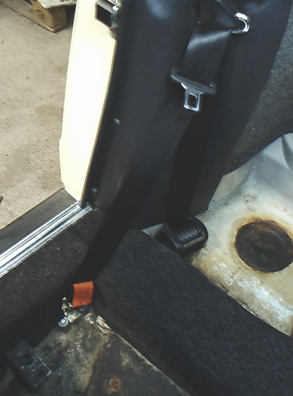

I looked in the search engine for seat belt mounting and location and saw some good info that dealt with what looked like 280sl and some 3 point mods.  My question:  Did the 1964 230sl have seat belts and if so where did they attach to the body?

I believe the common belief is that all W113's had the same mounting points built in from Day One.  I don't have seat belts, so I can't describe where they all are.

« Reply #3 on: August 27, 2004, 01:06:34 »
Yes, the early ones are prepared
too. Feel the holes through B-Post-
Cover. Also see two more holes when
removing tunnel carpet. They are
closed by thick plastic srews.
In no belts have been installed
before, one has to drill 2 extra
holes for 3-point aut. belts
(see pic.) on each side. German
"Autoflug" are about 185,35/Set.
For 2 point "airplane" belts with
chrome lock (about 198,28 Euro/Set)
in classic look one has to drill
1 hole only on each side.
See those two kinds of belts on
www.pagodenteile.de/38.htm
and
www.pagodenteile.de/43.htm
(see insible installation
of the aut. box under the
back wooden coverings.)
