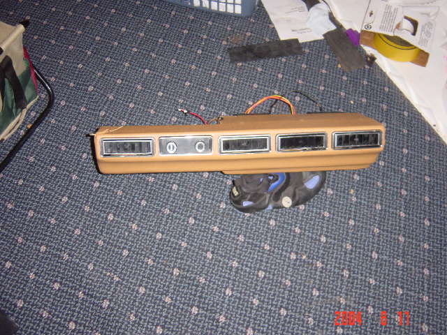

Having gained alot of confidence in my upholstering skills after recovering all my dash pieces, I decided that I never liked the black unfinished look of my under dash A/C evaporator. Mine is not the Frigiking, instead its a popular aftermarket unit (SCS/Fridgette sold by Buds and probably others) but the plastic appearance I thought was cheesy and (lacking insulation) would sometimes form moisture condensation on the outside.
First I wrapped all the cold areas with 1/8" Armaflex insulation (self stick tape). Next I covered everything in Bamboo upholstery to match my interior. What do you think?

Great Job--are you sure you have not missed your calling as an "interior restoration expert"?
Where did you find the Armaflex tape as shown?

Local HomeDepot or Lowes should have Armaflex rolls. This is a high density black foam, easily cut and shaped, very useful to replace all those internal gaskets of the heat/defrost duct system which tend to disintegrate and clog up the outlet grilles.

Looks like you did a very nice job. You have succeded in giving it a nice custom appearance.

Mike and Mal, those look great, impressive work!  I have the same unit as Mike and agree it's quite plasticky, but in my car with black interior it doesn't stick out so much.  However, I do need to do something about the condensation and will check out the Armaflex stuff.
