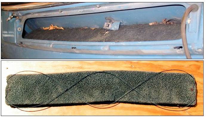

I am in the process of replacing the filter pad under the air intake cowl.
While doing this, I noticed that the left side hot air flap (the one also connected to the valve) doesn't quite fully close, and even with the lower left lever all the way to the left, it is still open by about a centimetre or so. Assuming this shouldn't be the case, how is it adjusted?  Can see the threaded rod connected to the flap and the valve with a ball joint type connector at each end. Do these just pull off and push back on so that the length of the rod can be adjusted using the threaded end?
Also, the air cowl filters have a spring loaded wire frame on one side that clips into the air intake walls. I think it makes sense for the frame to sit on the underside to support the filter, but I see some photos on this forum with the frame on top. Probably makes no difference to the functionality, but would be good to know which way this should really go.

The wire frame on the cabin air filter should face down. You want wires somewhat protected from the elements and also prevent the filter material from sagging:
http://www.sl113.org/forums/uploaded/66andBlue/20088314305_FreshairFilter.jpg

Thanks for the confirmation on the orientation of the filter.
