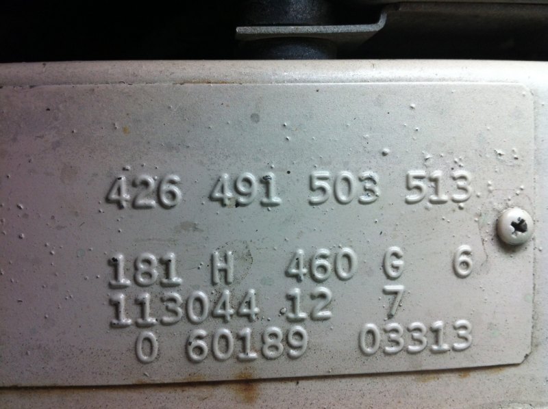

Chassis plate
It is missing from the car under the bonnet near the bulkhead. not a clue where it went. How and where do i get another or even can i ?
