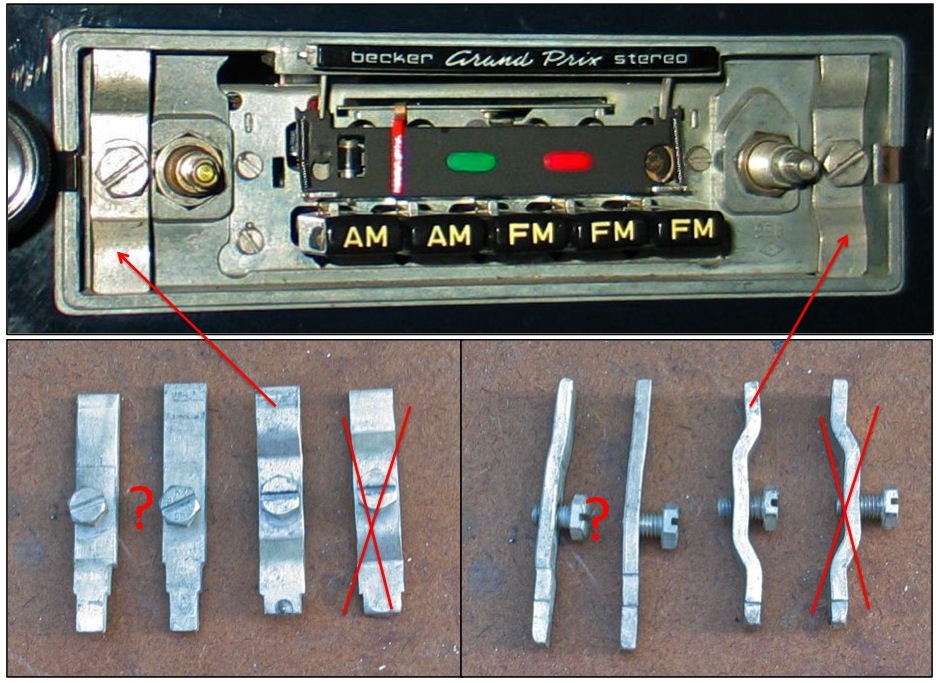

... - the "bars" that hold the radio to the dash, as supplied, did not do the job.  The problem was that the screws were not long enough to reach the front of the radio and thus hold it tight against the dash.  Becker called this "odd' but offered no other suggestions. ...
Hi Chuck,
had a similar problem today with the fastening brackets until I realized that I used the wrong ones, shown on the left in the photo with a "?".
Not sure whether they are for a different Becker model or perhaps a Blaupunkt or Grundig radio. Your brackets with the three steps at the bottom look similar.
http://www.sl113.org/wiki/uploads/Electrical/Becker_radio_mounting_bars.jpg
