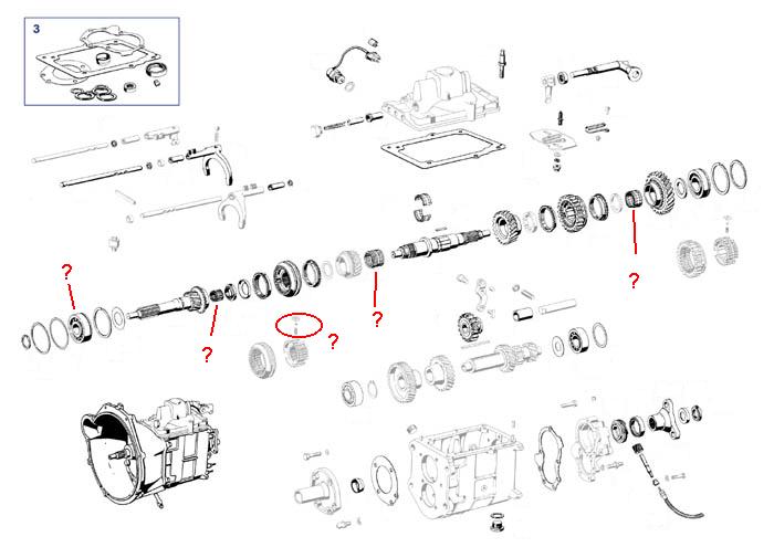

The invoice I have shows the following part number which I dont believe is the Merc # 0625617316, it may be an aftermarket suppliers number !
It is the bearing on the extreme left at the first question mark. If anyone has a Merc number for this I would appreciate it !

Only question I have now is that on all the parts diagrams I have found, and on my attachment below the bearing appears to be the opposite way around as far as the groove and the clip are concerned  ??
Anybody been here ?
  • Posts: 7507
Re: Manual 4sp bearing question ?
« Reply #9 on: April 01, 2003, 17:30:01 »
Hello Ben,
Very observent! That bearing is illustrated backwards. This group even is finding factory mistakes! The grooves must be oriented outwards for correct assembly. Be careful that the flat key and slotted ring on the top shaft remain keyed in place during installation. If they shift they will cause all kinds of problems. I use a hose clamp around the shft to hold the gear cluster tight until installed in the case. When the slotted spanner nut in the output flange is tightened later, it will  lock everything in place.
