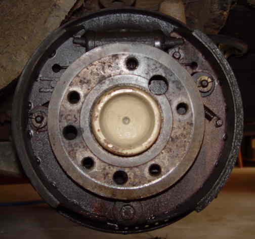

I was just working on my brakes today on my 230.  The rear shoe was over the front shoe on the left hand (driver's) side of the car.  I took a picture, but don't know if you can really tell much from it.
Please pardon the brake fluid, this was my leaking brake from my other post.

Dan--Thx--that explains why my shoe is scraping on the side. I'll go down and change it over. As I said in my post, I couldn't quite remember the order and all the manuals are mum on it.
