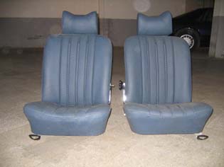

Hello..
 I was installing my seats today, and the Seat wheels on both seats to the inside are touching the Center wooden Console,it seems the seats are sitting low from the back! actually i cannot retract the seats??
Any remedies.

Thanks everyone. I do have the right seats, but Beliveing in Mercedes-Benz exellence led me to belive that there were 2 wheels on each seat?? I had non when I took delivery of the car last year, Now I can get on with finalising the restoration, the car is looking wonderful.
The leather and seat pads came from GAHH, and where easy to install and fit like a glove (Photo attached
Douglas, I obviously have extra seat wheels now. I bought them from Miller, and you are welcome to one, but I need to check the shipping cost to you . (mail service in Lebanon is non-existant)
Thanks again.. you guys are great

Mal,
The front/rear slide adjustment handle belongs next to the transmission tunnel on each seat.  In your photo, they are reversed.  I hope you did not put unnecessary holes on the new GAHH leather!

« Reply #8 on: July 10, 2004, 02:52:28 »
Thanks Rodd, fortunatly I did not put any unnecessary holes.
Seats were properly insalled in the car, which I hope I will take delivery of mid next week. and will post some pictures
