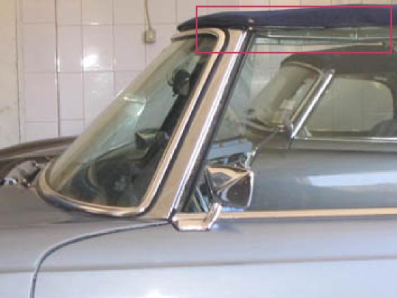

Thanks Bob, this clarifies things, I have not installed the springs yet, and this might explain why it is so difficult to open and close the top.
yesterday,I installed the new fabric that came from GAHH , but it seems very very  tight??
Also, the frame above the side windows is not straight, which makes the alignments to the window very difficult!! ( Please See Photo).
Any ideas on how to remedy these problems.
Many Thanks
