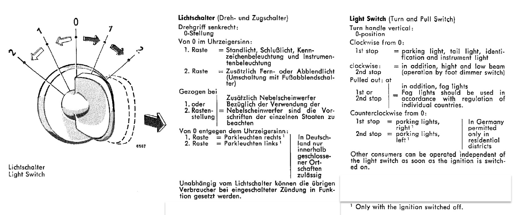

After some discussions and looking at a mostly original late 250SL I have come up with some ideas about the peculiar wiring in my 280SL.
The standard wiring as shown in the wiring diagrams allows one to switch on the fog lights both in position 1 (parking lights on) and in position 2 (driving lights on) by pulling the switch as shown here:
http://www.sl113.org/wiki/uploads/Electrical/230SL_headlight_switch_postions.jpg
But as the instructions state "Fog lights should be used in accordance with regulation of individual countries" and in many US States (perhaps all?) driving with fog lights and driving lights (especially high beam) was illegal.
As can be gleaned from the switch diagram (below)  in position 1 and 2 contact is made with poles "58" (and "30") and that closes the circuit through fuse #8 to pole N via the grey/green/yellow wire. Pulling the switch turns on the fog lights.
When this wire from fuse #8 is replaced with a new wire connected to a fuse and then to pole #57 the circuit is completed only in position 1 but not in position 2 and the fog light can be turned on only with parking lights in position 1. That is the situation on my 280SL as described earlier.
On the 250SL the situation was different. Here the grey/green/yellow wire was also exchanged with a new wire as above but after the fuse the wire went to pole #56.  That pole is only contacted in position 2 and in this case the fog lights are turned on only together with the driving lights. Does that mean in some states you can use fog lights only together with driving lights?  ???
How the side markers come into play is beyond me, but perhaps it has to do with the elimination of the fog lights in later US-style headlamps, e.g.type AN and AJ. That would have freed up the extra fuse box to be used for illuminated side markers when those were introduced.  ???

That sounds like an entirely plausible explanation. In some states, use fuse 8. In other states / countries use extra fuse. Choose which connection 57/58 on the switch to use to vary the behaviour.
In the Netherlands fog lights must be used with dimmed headlights. Using them with high beams makes little sense.

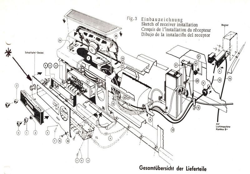

However, if your fuse box is indeed used for radio and and antenna then it should be moved to the opposite apron as shown in the installation instructions here:
http://www.sl113.org/wiki/uploads/Electrical/RdoMtg230r.jpg
or in the attached photo.

..... Putting a dealer added radio and or antenna and commensurate fuse box makes the most sense in the location yours is now, and mine is now--not where the instructions say.  ....
My dear friend Michael "Noitall" Salemi, Mercedes and Becker instructions are usually well thought out and I would not second guess them so easily.  :)
According to one very reliable source there is a red wire in the harness on the right side where the wiring for the voltage regulator comes out that is used for the radio and when none is installed it is bent back, insulated, and tucked under the sheathing.
On my car the fuse box on the left side was indeed used for the fog lights.  The car came with a (modern) radio was hooked up via a wire that was inserted in terminal 1 in the fuse box. Not a smart idea!
I'll go back to the standard wiring, remove that fuse box and move it over to the right side and hook up a proper old Becker radio and antenna as per the instructions.  I need to find (or make) a bracket to attach the fuse box to the regulator and hope to find that red wire.  I'll let you know if I am successful.
