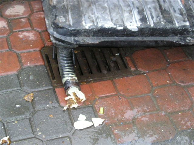

mille
Re: Fuel Tank Tour
« Reply #33 on: November 02, 2005, 14:42:47 »
Hi Joe,
Very useful informations. Thank you very much.
This is what came out of the tank during the restoration work of our Pagoda. No wonder we had problems with jerky running due to insufficient gas supply. It has now been totally cleaned out and the engine runs like a sewing machine  :)
/Finn

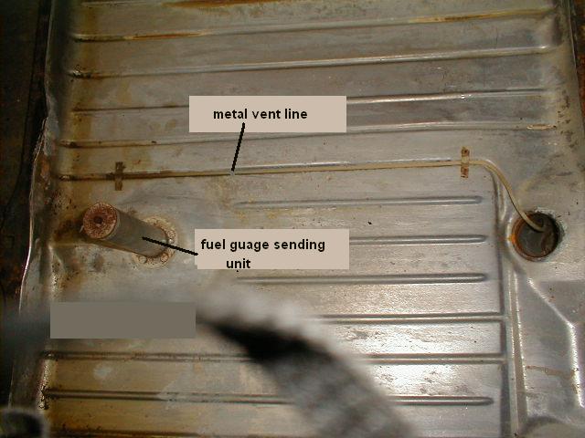

  • Posts: 7507
Re: Fuel Tank Tour
« Reply #39 on: November 23, 2005, 06:49:43 »
Matt,
Also be aware of the tiny vent line which snakes along the top of the gas tank and originates in the filler neck. Blow this line clear during the sealing process. This allows the tank to "breath" during fill-ups. If clogged you will have trouble adding fuel during fill-ups.
