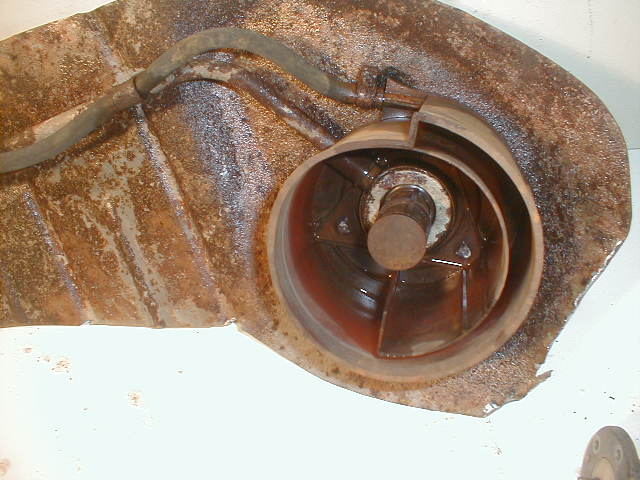

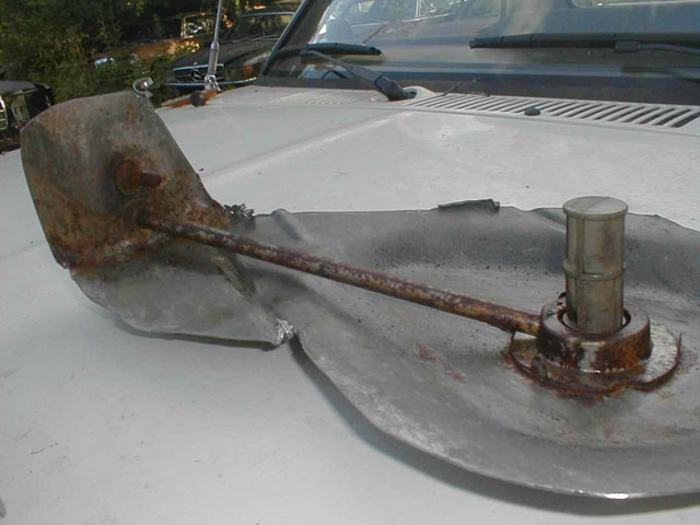

The inner workings of the W113 fuel tank are a mystery to most owners. I had an old tank which had been open and dried out for years. I cut it open and took some photos for everyone to see. If you ever need to re-condition your tank or service the drain plug/fuel screen this information should be helpful and probably not available anywhere else.
Here is an illustration of the complex "flower pot assembly" (thanks Dan for the terminology).

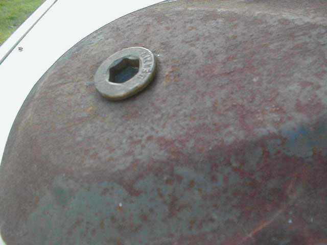

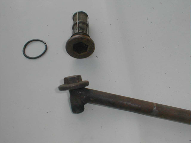

The drain plug/fuel screen in your fuel tank is the first line of defense to protect your injection system from contamination. This drain plug/fuel screen can be removed using a 22mm allen bolt (7/8") will work. I made a tool using a 22mm bolt welded on a pipe (see picture). The unit has a rubber o-ring seal which you may wish to replace with new. New drain plug/fuel screens are available new if yours is damaged. My old dealer (280-SL)parts book show the number for the filter/plug to be #111 470 06 86. The seal is listed as #110 997 01 45. These numbers may have changed. Any dealer should be able to cross ref. these numbers to current ones. Earlier W113 cars may be a little  different.  I believe the earliest versions of this drain plug/fuel screen may be metal the later units are plastic. In addition the early units may use a different metal seal instead of the rubber o-ring seal. Maybe some others can comment here.
Download Attachment: fuel tank8.JPG
74.44 KB
Download Attachment: fuel tankdk10.JPG
34.47 KB
The next photo shows the tank bottom without the flower pot to show how the fuel manifold interacts with the fuel pick up line. Fuel going to the engine must first flow through the screen and into the round "fuel manifold" where it leaves the fuel tank via the metal line. After traveling through the electric fuel pump, fuel lines, main fuel filter, injection pump, left over fuel is returned to the tank via the smaller metal fuel line and dumped into the "flower pot".
Notice where the fuel return line and the  larger (lower) fuel supply line enter the tank. Notice that the metal fuel supply originates at the at a round collector (manifold) in the center bottom of the tank where it picks up fuel after it is drawn through the drain plug/fuel screen.
Download Attachment: 4.3.JPG
60.17 KB

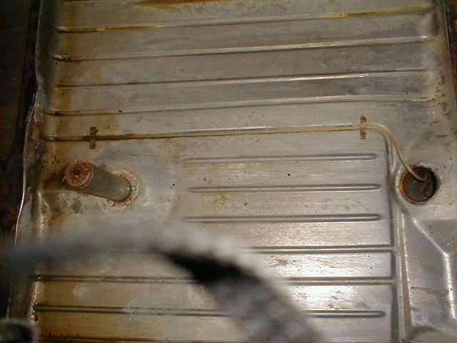

If you ever need to recondition your tank and coat it with gas tank sealer you should be very careful to cover the screen so sealer will not clog the round collector (manifold and fuel line.
Also be aware of the tiny vent line which snakes along the top of the tank! This must also be kept clear!
Download Attachment: gas tank top with vent line.JPG
61.14 KB
This tank seems to have a zinc galvenized coating from the factory and the surface is still in decent condition. I am not sure that the earlier tanks were galvanized.

I was wondering if you can just clean out the filter in the tank instead of replacing it. Do you think that's generally sufficient?
  • Posts: 7507
Re: Fuel Tank Tour
« Reply #2 on: June 27, 2004, 07:08:39 »
Hello Doug,
Yes cleaning the screen is usually sufficient. Replacememnt is needed only when the screen is damaged. These screens only catch the larger particles of dirt.

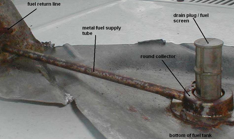

The sealer used in re-coating the tank may completely block off or restrict the metal supply line in the tank. You must close of the screen and it's openings with something like shrink wrap. Then install the shrink wraped screen in the tank before the sealer is poured in. This will prevent the sealer from entering the round collector and plugging the supply tube.
If your tank has already been coated you must make sure the metal fuel supply tube is clear. Use a wire or a long brush. A rifle cleaning kit has nice long brushes, various diameters for gun barrels and works nicely.  blow compressed air through the supply tube when finished. Happy motoring!
Download Attachment: 4.8.JPG
70.05 KB

My understanding was that the return line dumps fuel in the 'flower pot' (as described by the good doctor)  ;) .
On my 230sl the return line was longer and with bends and had to be desoldered  and removed to clear it out.

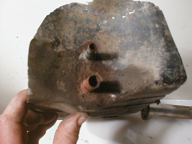

Sometimes it takes a few of us to solve all the mysteries. After reading your post I went on a quest for the "flower pot" tank. After rummaging through my scrap heap I turned one up (see photo).
Download Attachment: gas tank illus 2.JPG
76.79 KB
The principal is the same as the previous tank but more complexity. The return line is connected with a clamped rubber fuel hose to the "flower pot"! Return fuel is delivered in a small resivour "flower pot" right next to the fuel pick up.
Download Attachment: gas tank4.JPG
61.24 KB
This makes reconditioning even more difficult. Sealer will tend to collect in the "flower pot" and close off the return line. During and after the sealing process both lines will need to be kept from becoming clogged. Compressed air blown through the return line shortly after sealing will help. A flexible wire or cable (speedometer cable core)will be needed to clear any sealer or obstructions in the cuved tube. It looks like the tank should be set upside down after sealing so too much sealer is not collected in the "flower pot".
The same round collector as seen in the previous post is nested in the center of the "flower pot" with the fuel screen. these tanks are vertually the same except the "flower pot" and extra plumbing has been added.
Here is a photo showing the different diameters of the fuel feed and fuel return line.

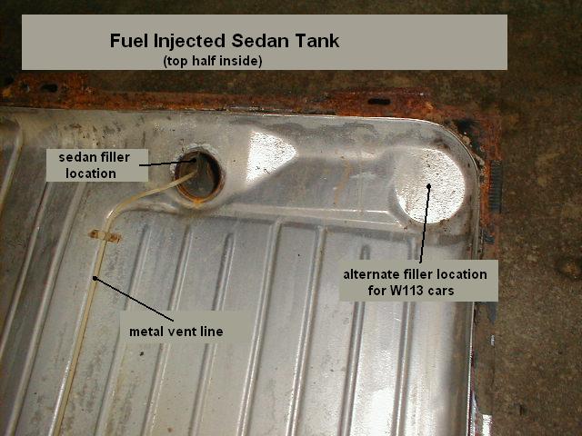

The latest research provides some additional information. A 1970 vintage tank yielded an internal "flower pot" assembly with all metal lines. The rubber line as seen in the inside of the earlier tank has changed to all metal internal lines.
Download Attachment: illate tank, flower pot illus..JPG
55.79 KB
Bhap, I finally got some information for you on the vent line. This photo shows the line which runs from the filler and along the top of the gas tank. This line goes to the plastic expansion tank in some of the models and to the charcoal canister in others. The expansion tank, or charcoal tank has a return line back to the filler neck. A third vent line has an external funnel shaped external vent on some models and a return line to the engine on others. I am sure there are different variations of the vent system on earlier W113 cars.
Download Attachment: alternate filler location illus..JPG
53.61 KB
Another interesting feature on this injected sedan tank, is that although the filler neck is in a different position on this sedan tank than a W113, there is a flat area where the W113 filler neck would be. From this I presume that the factory uses the same parts to make  a sedan tank as a W113 tank. Where  the filler neck is installed makes it a sedan or W113 gas tank!
« Last Edit: June 30, 2004, 23:11:01 by ja17 »

Note the term '' flower pot '' was coined by the Benz Dr. and he will permit this group to use it for now ~)
 Now that you can all see what it looks like let me tell you how it works. Right where the return line ends there's a small hole right at the bottom where fuel enters the flower pot when the tank gets low. The high volume of fuel coming out of the return line causes a vortex to form inside of the flower pot and a low pressure area right at the end of the pipe. This low pressure area is right at the hole in the flower pot and actually pulls fuel in from the main tank area.
 The flower pot acts like a dampener so that you don't suck in a lot of air going around corners. Since all the returned full is dumped into the flower pot it never goes dry - there's far more in there than the engine needs.
 This is why it's so important to have an unrestricted return line. Not only does the high volume of fuel prevent vapour lock inside the injection pump but it also acts like a heat exchanger by lowering the internal temps of the IP.
The flower pot is both simple and very effective - just short  of brillant.

I wanted to remove the fuel drain plug in my 66 sl to clean the scren and to check for debris in the flower pot.
I tried to use a 7/8 bolt and a vise grip to remove the plug, but that sucker is either stuck or I need a  better tool.  (the vise grip would slide)
should the drain plug require considerable force to remove?

I guess I have to give up another one of my secrets.
  The drain plug can be removed using a spark plug socket with a hex head on the drive end. This socket should have a rubber insert used to hold a spark plug which you need to remove.
Push the hex end of the socket into the recess of the drain plug. Fit a long extension through the socket into the square drive from the bottom and remove like a regular drain plug.
