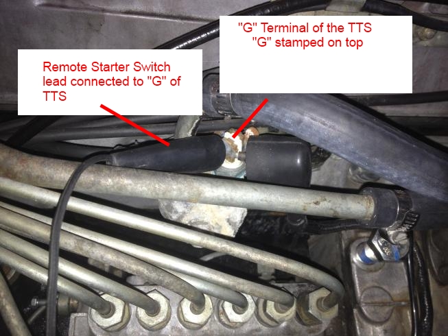

Yes, most of you already know this but now it's easy to find via the main forum search!  ;D
[How to] use a remote starter switch

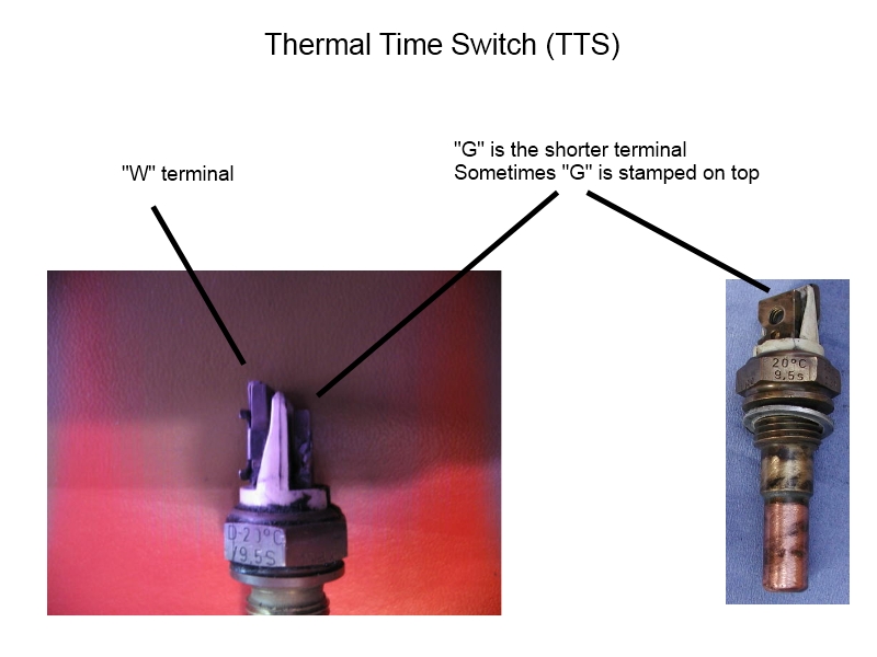

Attach one lead to the + pole on the battery and the other to the ā€œGā€ terminal of the thermo time switch to engage the starter.
Remember to turn the key on if you want to start the car when engaging the remote switch. .  Also don't forget to be In Neutral or Park :)
Spark plugs can be in or out.  Obviously "in" if you want to actually start the engine :).  "in" or "out" if you just want to rotate the engine (key off).  "Out" relieves any cyclinder compression which makes the engine turn easier.
Be advised that the fuel pump is activating when you are using the remote starter switch in this configuration.  You can pull fuse #4 to disable the fuel pump if not needed.

Please feel free to add any pics or advice for other methods.
