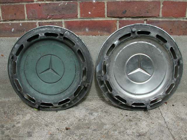

The backsides of the original 280SL wheel covers (hub caps) were painted in a kind of "military green".
See: http://www.sl113.org/wiki/uploads/WheelsTires/280slhubcap_inside.jpg
Has anyone found a good matching color in a readily available spray can?

Looks like I found something that is a very close match to the original color - and it is dull.
But it is a primer, and now I am wondering whether the wheel covers were delivered by the OEM primed only and then the correct hardtop color was painted at the assembly plant on the front only.  ???

Alfred--are you sure there was paint on these wheel covers?  Looks like a nice uniform rust to me, but it could be the photos.  I don't recall seeing any paint on the old steel wheel covers I once had (and I'm pretty glad I now have stainless... ;) ) but they looked pretty similar to what you have, maybe a bit worse.

I would agree with Michael that the rust on the hubcap backside is probably due more to expose to the elements than the plating theory. The more concavity (is that a real word?) the worse the problem.
Alfred,
That color looks a little on the blue side from the hubcaps I have seen. Of course it could be the picture lighting and such. I was thinking the grey/green color stopped just before the slots around the rim and was only in the bowl area. You can see the line where the rust isn't as bad. That is where the paint line stops on my hubcaps. As evidenced with this hubcap, paint sometimes traps rust and makes it worse underneath.

...   Looks like a nice uniform rust to me, but it could be the photos.  ...
Michael,
I suspect that your glasses are now starting to "rust" - have you seen an optometrist lately?   ;D
I can see the same green in the center as that shown in our technical manual:
Unfortunately I don't know who the contributor of the photo is. Anyone out there claiming ownership?
Wallace,
the color on that old rusted wheel looks pretty much like the one in the tech manual. But you are correct, looking at colors on a computer screen is problematic.  That is why I put the cap on the wheel when I shot the photo and by all accounts they are very similar.

photo of my wheel cover with natural lighting from the California Sun. I used to rotate the tires myself and when doing so always scrubbed the under carriage, wheels and wheel covers. It did help preserve them pretty well. There is a slight darkening due to brake dust. Hope this helps in your quest for the right color.

Re: Backside hub cap color match?
« Reply #16 on: September 24, 2011, 09:29:46 »
Guilty  :D
Guess I should have cleaned them up first!
Naj
