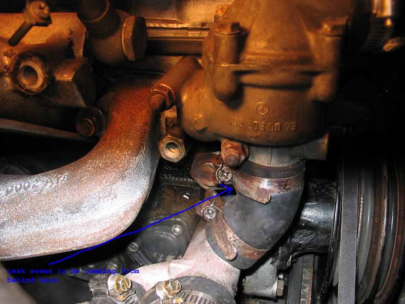

Here's what the side of my engine looked like after running the engine for a few minutes, Saturday:
Download Attachment: Leak.jpg
60.66 KB
...yes, I was quite sad. See the fluid on the block? IT should be clean and dry!
Question: does this look like a water pump problem to you? Perhaps it's the water pump housing gasket? Is this the typical location for seeing leaking coolant when a water pump goes south? I assume the fluid is headed rearward due to the wind blown by the cooling fan.
Using a small mirror I tried to get a good look at the location where the thermostat housing mounts to the head. This appears to be dry. I suppose I could have a cracked head or block but ...well... I don't want to even think about that.

William--You could have a couple of things going here, but before you ponder the worst--head problems--you might want to check a few things a little more closely. First thing I would check is the water pump vent pipe. That's the little U-shaped line that runs from the water pump housing to the front of the head. There are two hollow bolts that attach on either end. Make sure the leak is not coming out from under these bolts. There are sealing rings on either side of the banjo fitting and you may have upset these when removing the a/c bracket assembly. Next check the housing itself--there is a gasket between it and the block. You can't check it direct;y, but it is under the face of the housing against the block. Again, the housing to block seal may have been upset in the bracket removal process. Finally, the thermostat housing also has a gasket between it and the engine. Looking at your picture, I would guess that the leak is coming from one of these three things. The water pump replacement process should be no big deal if the leak turns out to be there. I say no big deal only because I've seen from your earlier posts that you've had the engine front disassembled before and you know what and how things come off to get at the pump itself.Good luck--George Des

Thanx George. The leak is what got me into this mess. The leak is what made me remove the bracket - to try to find the leak. Anyway, I checked the fittings on the, what was it, water pump vent tube? Yea, they are clean and dry. Water pump is clean and dry all around. I believe, now, that my leak is from between the block and the water pump housing. Just my luck! It couldn't be something a little easier to get to and replace. Now, I've got to remove evrything, all over again. Oh, well. I hope the kids remember what I look like.
Can I get the waterpump housing off the block without removing the water pump from the housing? Should I attempt to replace just that gasket, or go the whole nine yeards?
Being I really don't want to do all this a third time, I'm considering replacing the water pump housing gasket, the water pump gaskep, and the water pump. It'll cost about $100.00 more thna just replacing the gaskets, but I shouldn't have to worry about this again for a while.

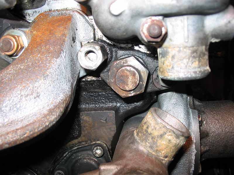

This thing, right?  This is the 'kut'... that big nut looking thing square in the middle of the picture?
Download Attachment: BigNut.jpg
69.4 KB
1971 280SL US Automatic
« Last Edit: May 26, 2004, 06:05:31 by blairwag »
Re: Where is a typical water pump leak?
« Reply #11 on: May 26, 2004, 06:33:13 »
William,
Yes, right  ;)
