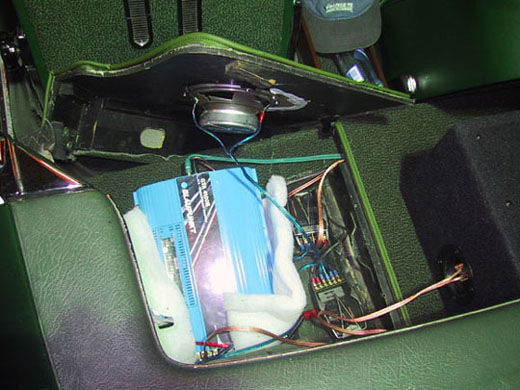

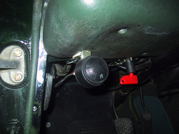

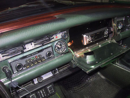

But good sound quality is important for me as well so I hid the player inside the glove compartment. Took out the inner box and made a plate with the standard DIN hole. Had to mount it all the way to the right to get enough space behind. There were already holes in the plate behind the seats so I mounted 2 Kicker mid tone speakers here and let the sound go through the carpet. The amp and freq. splitter just fitted in the room as well. I have a SUB lying loose in the middle. To tweeters are mounted under the dash on a bracket with only one screw in a hole already there. I can remove the SUB and tweeters in 30 seconds.
A little hard to operate the player with the seatbelts on – perhaps a remote control would have been nice. The sound is great!

Finally managed to upload my pictures so here is my present solution:
