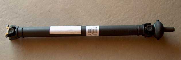

Re: Driveshaft balancing
« Reply #10 on: May 17, 2004, 19:14:00 »
Hi Dan,
I'm assuming you mean don't try to press the U joints onto the shaft at home. Wouldn't even think about attempting it. I thought about ordering the 2 U joints and having them installed by a drive line specialist who's familiar w/ Merc. After talking to him I decided against it. He told me if I wanted perfection that I should order a new shaft from the factory. So I did. It turned out being only 90 bucks more than the cost of the 2 U joints and labour to press them on and balance the old shaft. For that small of a spread I didn't want to jerk around with the old shaft.
From what Cees pointed out about the weight on the shaft I now know it's factory balanced. My question is, do I just pull the old one out and put the new one in? Or is there some kind of balance issue with the front shaft coming off the transmission.
By the way Dan, I don't even know if you remember helping me with pre- purchase advise a couple of years. I was a jerk for never thanking you so I'm do it now. Anytime you're in Cowtown you've got a bed and beer at my house.
