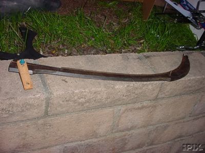

After taking the two wood trims out, I saw two small pieces of light wood laying near the speaker hole. I'm no engineering whiz so I thought they were braces for the speaker...
But the attached photo shows a wood piece just like the two I have. Looks like it's attached to the trim end.
Are my two little wood pieces some kind of shim or brace for the two wood trim pieces? How do they go on?
Maybe the order they go on is: wood trim on top of dash, wood shims under dash to hold the two trim ends to each other? then the washers, then blue plastic holders? Are both little woods used, one on top of the other? Yes No?
Sorry but I didn't see where the little wood pieces came from.

Richard,
those 2 pieces of wood support the trim pieces in the middle.  From top to bottom, the arrangment is: wood trim, the 2 shims, the metal dash support, and the 2 blue nuts.  The studs in the wood trim go through the holes in the shims.
